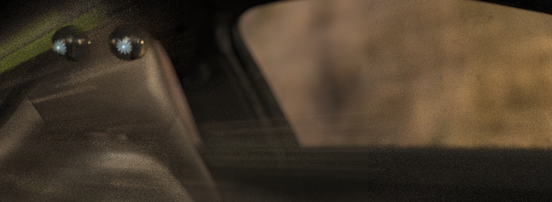

I have an issue with the motion blur with a character into a car.
My character is fully blurred, it seems octane is considering my character is far away and not into the car.
What is the setup to have the good moblur ? I tried everything. Vertex moblur/object moblur/etc..
I post you a picture of my issue. This picture is funny but not really what i want :D
Thanks guys !
G.

Hi finkaboutit,
try checking is any pivots grupped was in incorrect position.
Regards
Paride

Thanks Paride,
My pivot point is at 0,0,0, because my mesh is animated by character studio. Octane seems to don't understand this when he calculate the moblur.
I found a half solution through an ABC export, but he don't calculate the good velocities and my mesh is less blurred than before but too much blurred.
i have desactivated the moblur, it's the only way i have for now.
thx

Hi finkaboutit,
could you share (in pm) your scene exported to .abc?
Regards
Paride
