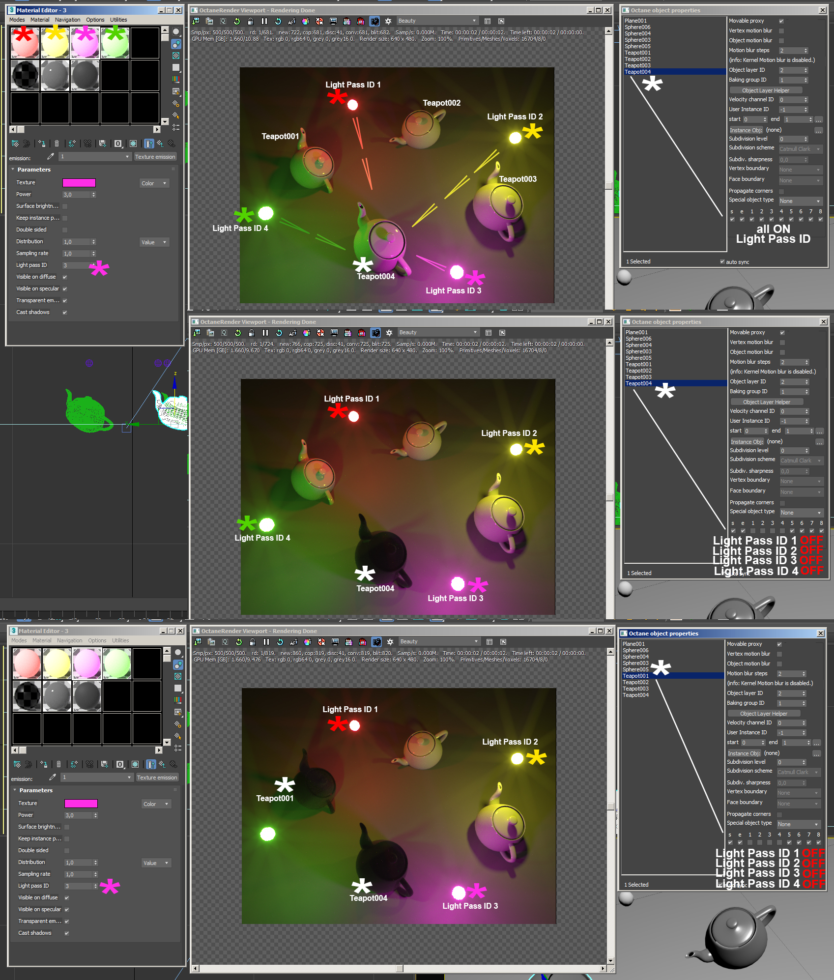

Hi Guys,
here how-to new Octane V4 Light linking ID feature.
Regards
Paride

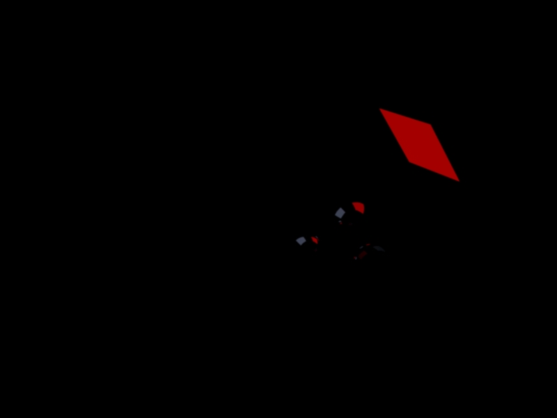

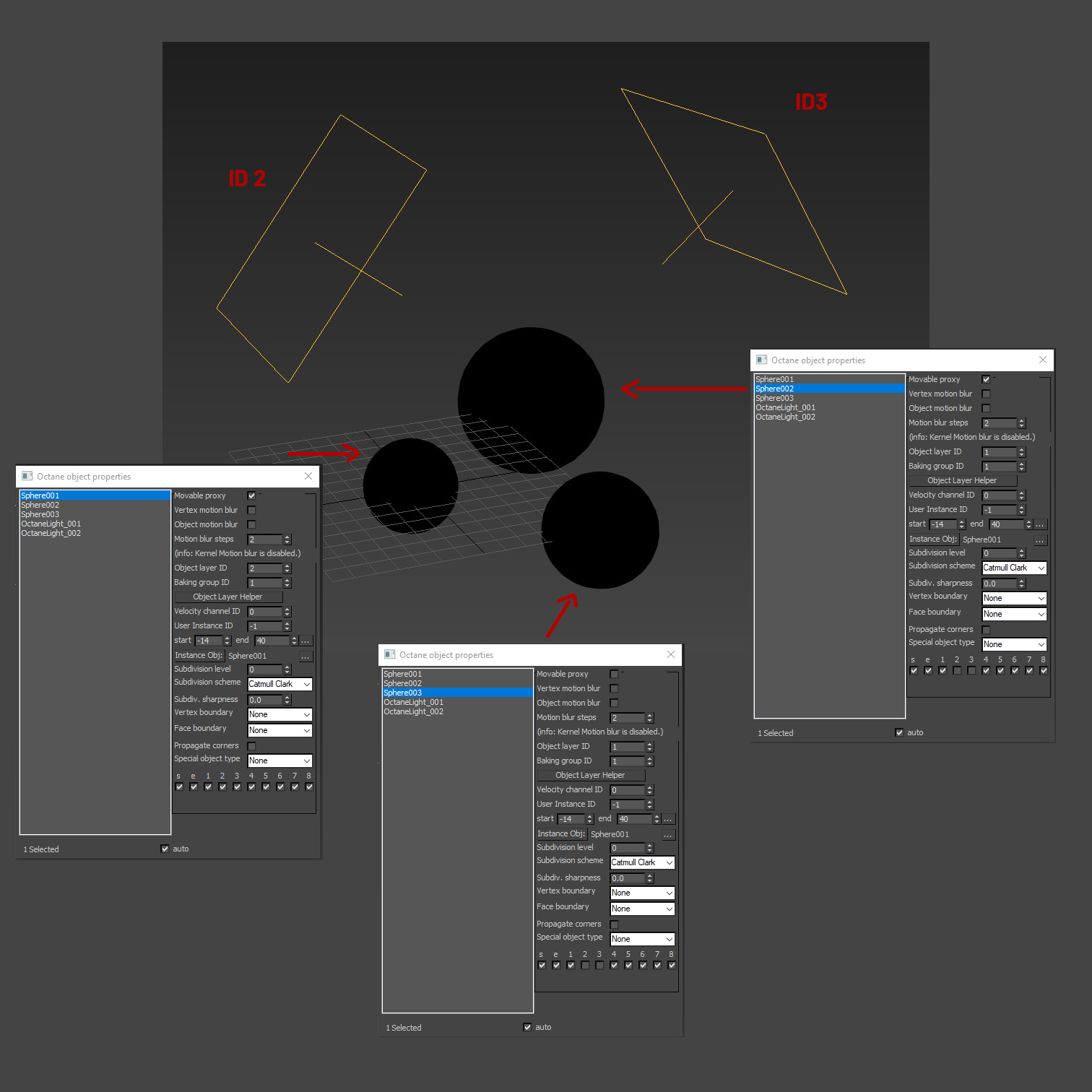

How are you able to have the "movable proxy" ON
and still have the light linking ID work?
At my end i need to have Proxy OFF for it to work.
3ds max 2016
Octane 4.00
Octane plugin 3ds max 4.00 - 6.10
Here is the maxfile
Movableproxy_LightLink_.zip
(27.73 KiB) Downloaded 467 times
-Mats
http://www.stir.no
paride4331
Posts: 4002
Hi Stir,
it should depends on visible option in OctaneLight, but my advice is set movble proxy on.
I found something not right to me, but nothing around your issue.
Regards
Paride
