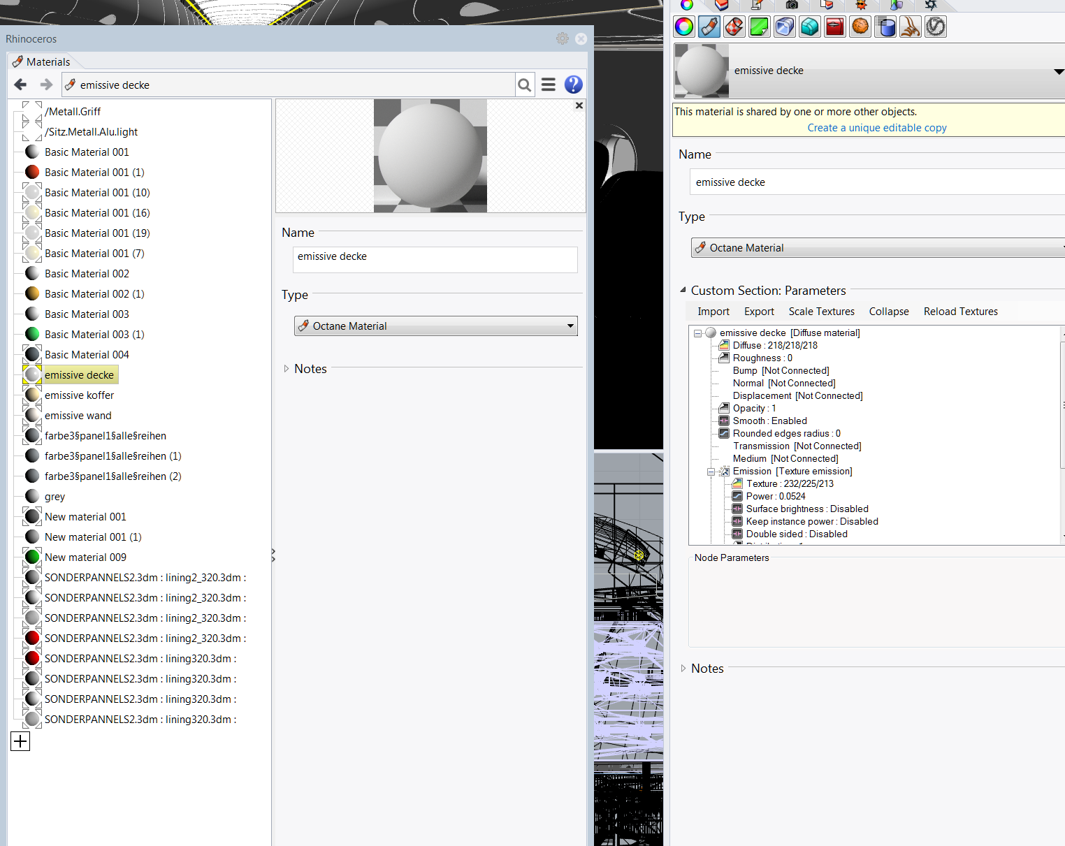

if my scene contains simple Rhino materials and I try to switch the material type to Octane, than there are no controls. Only if the material is assigned to an object than the options can be controlled at the object properties. Looks like a bug.

I have noticed this before, and it is a bug in Rhino6.

Should I request it at the Rhino side or are you fixing it?

I have reporting a number of bugs to McNeel but cannot recall if I reported this specific bug - so you should report it just in case.
