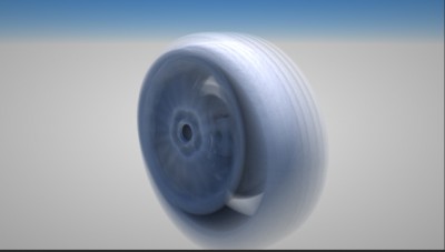

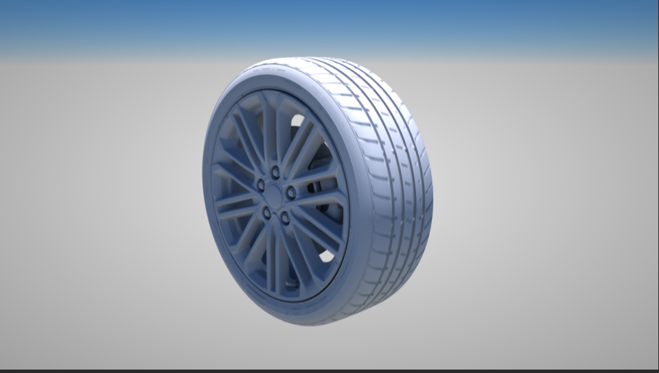

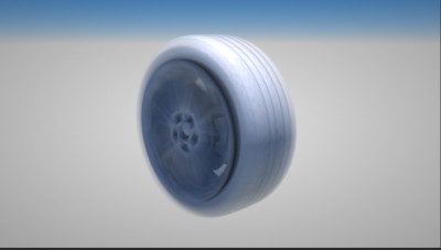

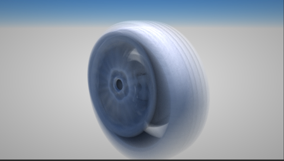

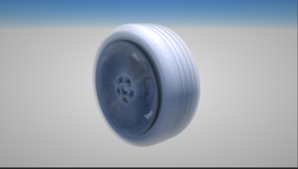

dear octane team,
we are using octane since version 2.x here as a production renderer. unfortunatly since the very beginning motionblur was a big issue in octane.
It is not possible to get a proper motionblur on like spinning wheels. Even in this new 4.0 release motionblur it still fu#%ed.
The entire wheel is getting bigger or smaller and blurry all over the place...
We are working in the automotive business...motionblur on wheels is essential! there must be a way
please see attachments for what i mean.

Yeah, that's a big problem of the Maya plugin. We need to render parts of the scenes with 600 fps to minimize those problems.
I can't understand why it is still in there.

Is this issue isloated to Maya plugin only? I'm having some movement even in my standalone scene. The wheels are animated over 100 frames but maybe that's not enough frames still.
I'm still slightly baffled as to why Octane makes animating motion blurred wheels a problem. Motion blur should just be a checkbox and it should react to real world values on both animation speed and camera settings (f-stop, shutter speed etc)

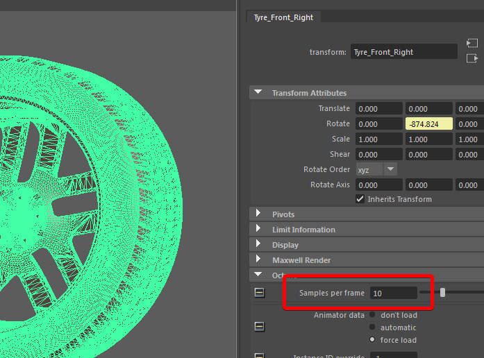

This is setting issues Guys is not explained well basically add subsamples at 10 should be fine for that. at Render settings "frames to pre-cache" set "0" default samples per frame set "10" we are rendering a lot car here is working pretty well if you have a really fast Motionblur maybe add extra subsamples like 20 but is not nescessary.
One thing to keep in mind if you want change the time line while doing IPR here a problem you need set the "frames to pre-cache" the amount of frame on you shot let's say animation 1-120 set "120" and then you can change time line this is cool but not fine with heavy scenes so set 0 and restart iPR before change frames.

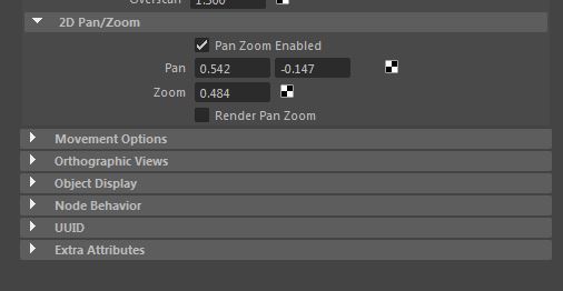

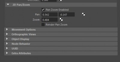

Is it possible to add support for 2d pan zoom and filmback settings?

@teammach, @Refracty and @ leehenshall
Hey guys, I'm not sure if you are aware of the new per object motion-blur subframe sampling feature in the new Maya plugin :
Motion blur interpolation is always linear in Octane = no rotation motion-blur, so more transformation samples are needed for proper rotation motion-blur,
this can be done in the Maya plugin now by increasing the "sample per frame" attribute of the transform node with the rotation animation.

damn, you are totally right. that fixes the problem! how coud i have not seen it...thx man
