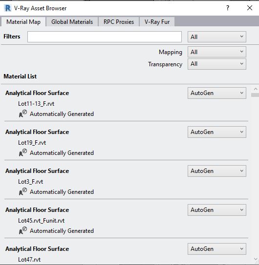

Such as "Material A" in rvt1.rvt in a shape like rvt1-Material_A, means just adding the link's name work together with the material name, so no matter what the origin name (or ID) is, they will never conflict with any other material (from the main or other link, sub link etc) I guess vray and even revit internal render engine are doing similar things, If we are looking into vray for revit's material, we can see from which link they are coming from.
3. since all revit projects are starting from given templates so all the revit default material that from different project will have exactly same ID , means they are born conflict with each other if to use the ID directly, I guess...

Though Vray rendered really slow, yet it take 0 time on this, consider the work load for manually changing this and that, vray maybe much easier, at least the workload leave to people is much less, and in total time Vray may also be even faster.
So please take a look into how Vray is dealing with this kind of issue
