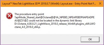

I switched out the plugins from Octane/LW v3 -> v4 and I get an entry point not found. Removed the master plug-in as well to update. Octane v4 standalone works perfectly though. Is it a driver issue? I'm running on Win 10 Pro/NV P5000 411.95. Do I need to re-install something?
When I go back to Octane/LW v3 the plugins detected and runs just fine.

did you overwritten ALL The files (not just *.p), you need *.dll and dat files also, This looks like you are using old dat/dll files with never version.

Ah ok! I got it working now. :D. Yes I had to overwrite the .dat/.dll in /bin folder. I was running it from the extracted folder. lol

You can, and in fact, you should, run the plugin leaving all the Octane system files at the same place used by the plugin .p file. Now you don't need to copy the Octane system files to the LightWave/bin folder. If you leave the Octane system files in their original place, you must delete all the Octane related files from the LW/bin folder to avoid problems.
