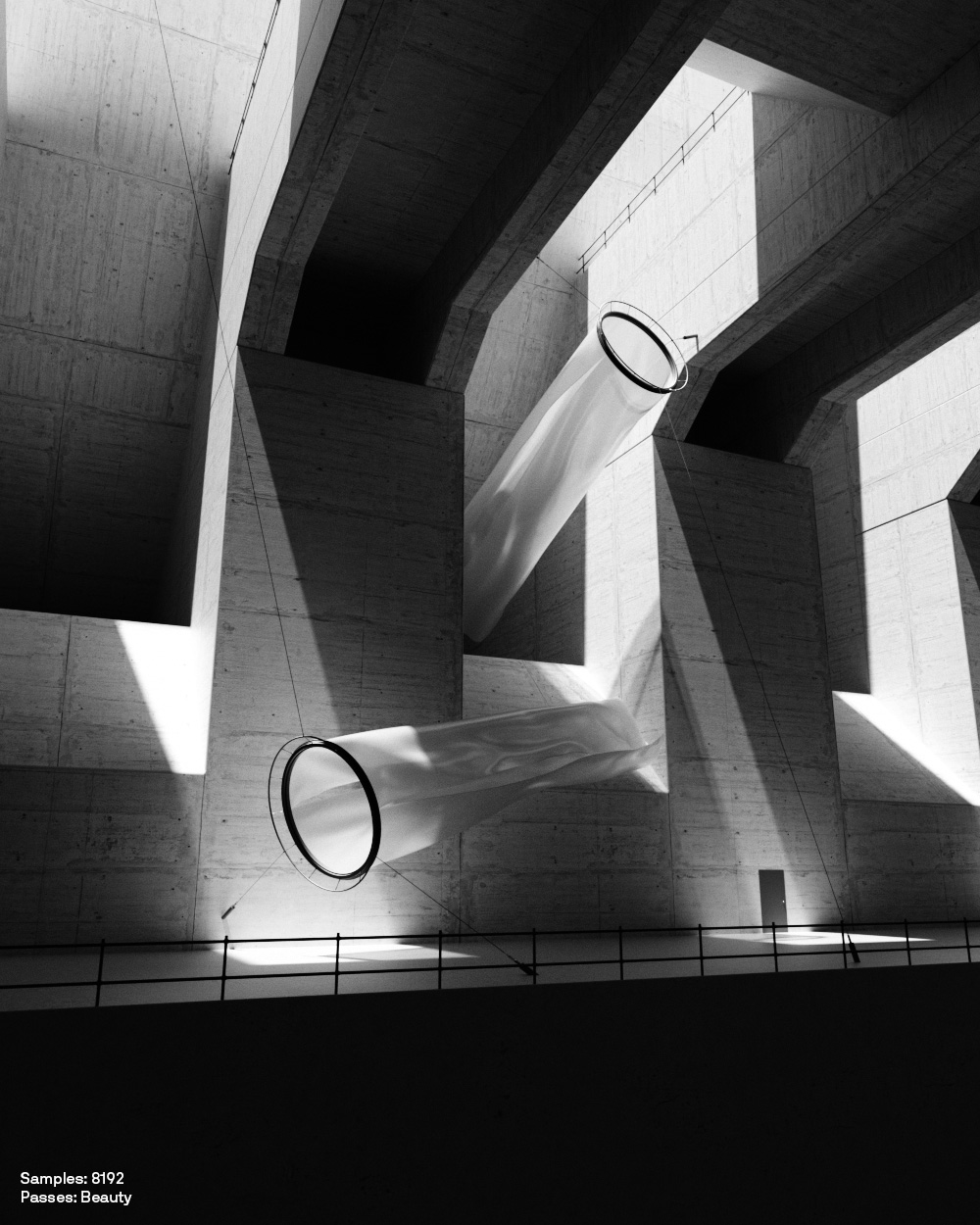

My best practice has been separating the beauty and denoised beauty, then compositing the denoised beauty over the top of the original beauty with a little opacity, the amount differs from scene to scene, sometime 80%, sometimes 40%. There is an option for this in the denoiser called mix I think but having two passes gives you that extra control.
I've made 4 images here for you to take a look at, this scene could actually be optimised much better, but this is a good example of a successful workflow with the denoiser. I'd suggest you lay them over each other in photoshop and turn each layer on and off to compare the difference. I might add, that this was also an animation and once converted to H264 and absorbed by most platforms it loses 90% of the detail anyway.
