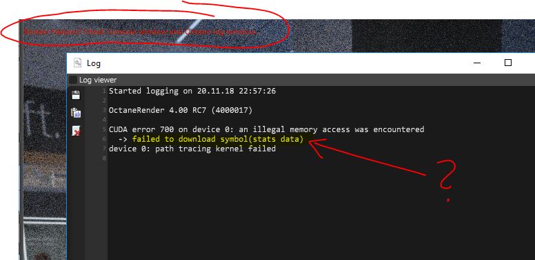

anyone got an idear what this means?
Only shutting down and restarting C4D helps to continue working on the scene!
Happens last weeks more often.
Sadly on a compex scene which I cannot upload.
But "failed to download symbol (stats data)" should mean something.
Thanks Mike

Cuda crashes! Wait for stabile release.

o.k.!
Thought V4 RC7-R3 is stable enough now for changing from 3.8
thanks for info!
Mike
Posts: 16068
Location: Türkiye
miohn wrote: Thought V4 RC7-R3 is stable enough now for changing from 3.8
Mostly yes, but in some cases this happens. Most likely that's fixed on next build.
