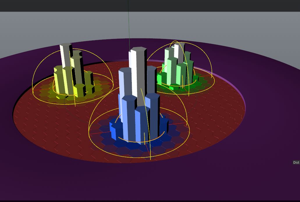

Since I never really needed it, I'm kinda lost when using the Mograph Color Shader, especially with Octane. To make it short: ist it possible to grab the color Information from an effector to use it in a simple glossy or emissive material? Please see the attached screen and, especially, the scene.
As I said, all I need is to have the clones shaded as in the viewport.
I would really appreciate it if someone could help me out. :)

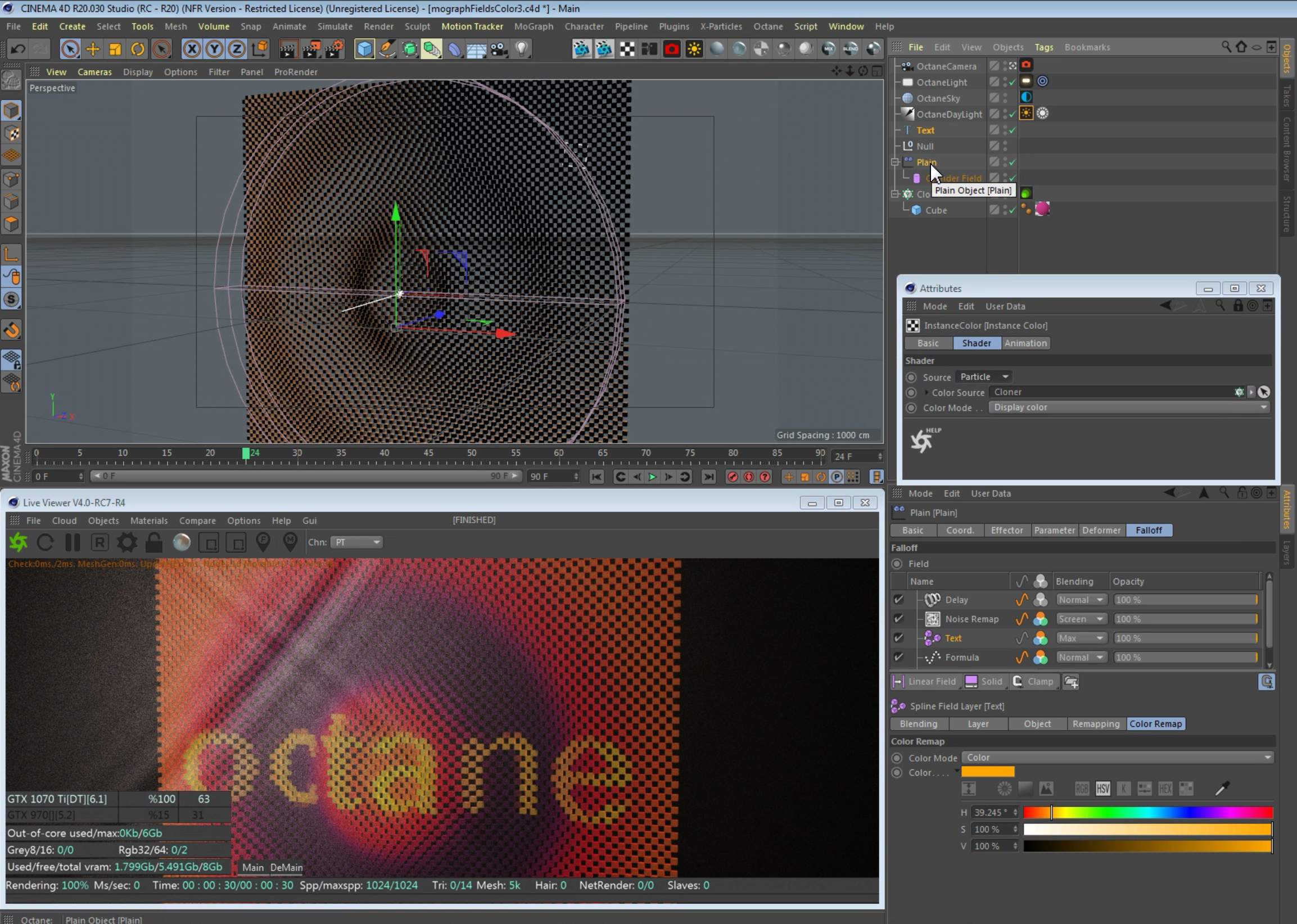

Have you checked manual for InstanceColor texture?

also check R20 with Fields, you can do whatever you want with clones:
ciao Beppe
