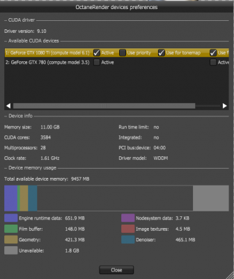

I tested a v3 scene at v4 (Rhino plugin) and a frame of my animation needs 24s instead 11s before, if I enable the denoiser. The sampling rate of MSamples/s is nearly halfen during the calculation. What do you think? Is it caused by the GPU setup?

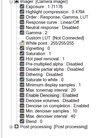

Make sure it is set to “denoise in completion” or else it will denoise whole rendering, slowing both down (in expansive for giving you live denoising updates in the viewport)

I enabled "denoise on completion" and it's the same. Also if I disable denoise at the device setup, than the render time is more than doubled, also if no denoising is done in this case.

Only 1080ti enabled - denoising on 37s and denoising off 20s. Also I don't understand why enabling the old 780 halfen my render times - (denoising off) 1080ti 20s and 1080ti+780 9s.

Strange. Can you export to standalone and see if this is still the case? What if you increase the max samples by 10? What is the resolution?

It's the same at the standalone. Resolution is 1080x1920. Which samples should I try to increased? I increased the kernel samples from 800 to 810 and it's the same. I will send you the ORBX file for testing.
