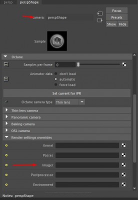

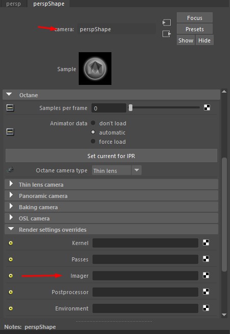

Both worflow are possible in the new plugin because you can also override global render setting nodes per camera.
In the attribute editor of the camera, in the Octane section you can find a subsection : render setting override
here you can connect another imager / postprocess / environment .... , and access it later trough the same way to adjust it.

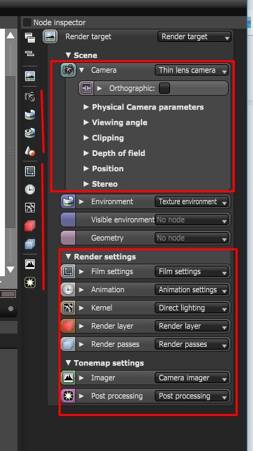

Your post prove my point!
See how everything related to camera is close to each other in standalone? Although things are in different menus, they are all in the same spot making everything camera related quickly/easily adjustable--as it should be.
This is very much not the case with maya--you have to go to three or four different places to make camera/rendering adjustments in maya. It is extremely disjointed and inefficient and to me, doesn't follow the organization of standalone.
Anyways, just a suggestion to make the plugin more efficient to use in production.

I understand... well we are using in big productions and is fine not a problem at all is better cause is more flexible on multiple workflows...My point is on standalone is not camera option , and as you can see is just because all options is on render target.
but also as you know you can override any of this nodes per camera like render target. (pascal point screen shot)
So I don't understand why all the troubles on the first place. or maybe we are not understand your point can be that to. I don't know but for us here everything is fine. if you work on nodal on render settings or camera is your decision. I personally use all on the camera sometimes like rendertarget, but "same nodes" are connected on the camera and the render settings windows.
I also attach a scene check the persp camera you have the same nodes as the render settings is like before. and you can add different option per camera... you can see you can have two kernels on the same scene. which is great in some cases.
