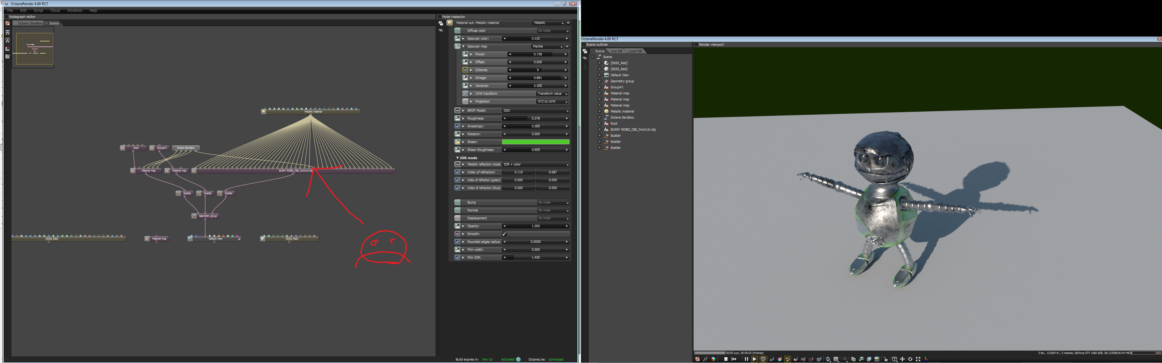

Thanks for updates. Hidden geometry combined with scenes seems to work. Nice
(When switching on/off layers results in SU gui get auto hidden, annoying but a low priority)
Same bugs with materials and proxies as before.
A workaround I used in v3.8 was to edit proxies in Standalone and use the "left click on proxy in SU >Octane Proxy >Update"
But now you have to close/reopen SU file for this to work.
And some times the octane plug-in relink a lonely material inside "Octane Sandbox" (se picture below)
edit: Linking proxy materials inside "Octane Sandbox" is a BAD thing
Remember that proxies almost always has a highly complex node setup.

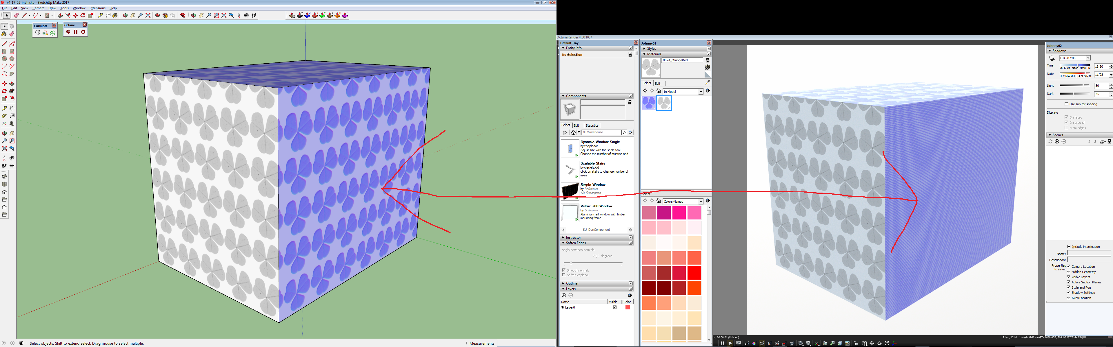

Win7 Sp2____2xGTX1060 [email protected]____Su17.2.2555 and Su18.0.16975____SketchUp Plugin 4.00.0.17____4.00.RC7 Standalone
The UV scaling bug has gotten even wors....
When reopen a SU file every texture has been scaled down, happens randomly? ca. 50% (se picture below).
I can fix this by >Texture>Position and, >Texture>Reset Position
But it's not user friendly if you had to redo 50% of your work every time u reopen a Octane SU project!!!
Also I still can't use "Create Material" only predefined materials. I mostly use "colors-named".

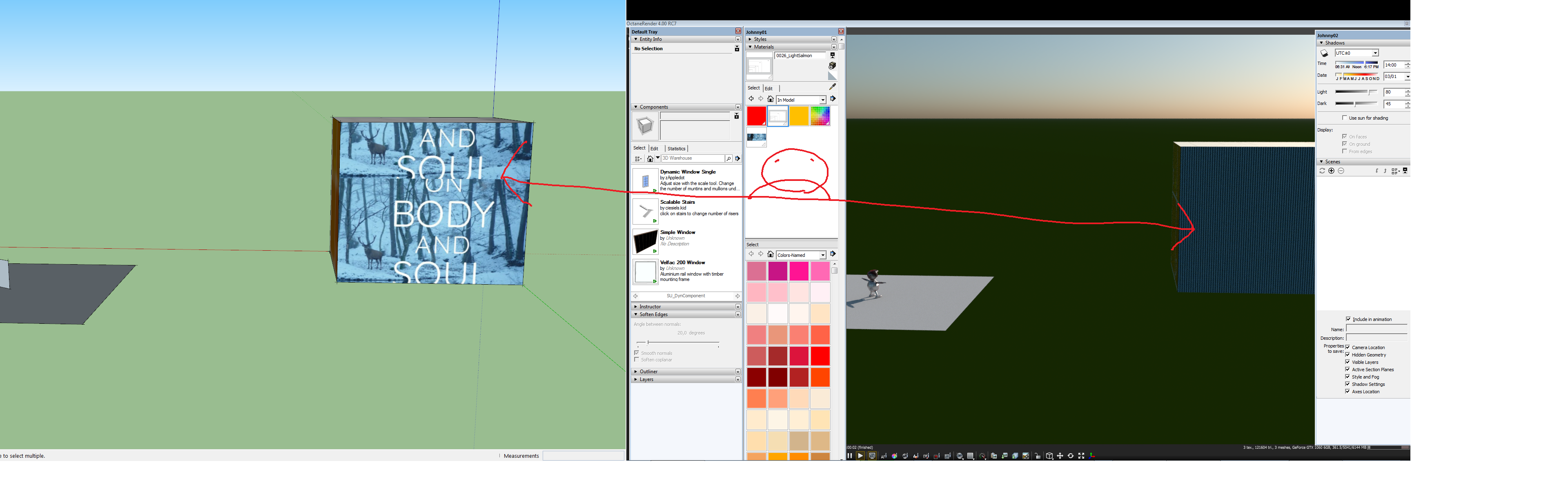

Here are a SU document for debugging (nb, I tried changing to a SU inches template to see if any effect).
The texture scaling issue is random. It happens on reopen and when assigning new materials.
Images I assign inside "Nodegraph Editor" also get randomly linked with images from the temp folder at reopen.
NB: The only link we need after a texture are assigned in SU is the ability to change UV mapping!!!!
And that settings and nodes created in "Nodegraph Editor/Sandbox" get saved and not randomly altered!!!
And when this is achieved > bring back the old functionality where you could left click a surface or material and regenerate it from octane material.
