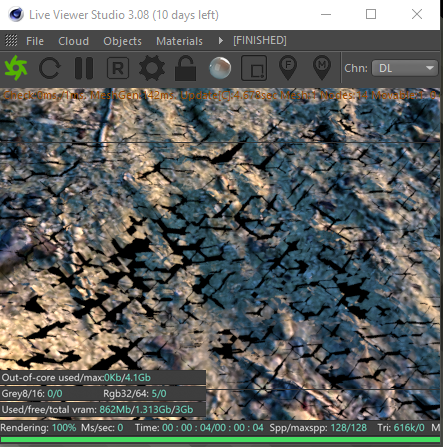

Hey all,
Just started using Octane and I'm running into issues with displacement. It seems like the geometry I'm trying to use displacement maps on is, for lack of a better word, "breaking".
If anyone has any solves please let me know. Thanks for your time!

check to have have Displacement in Follow smoothed normals mode, and if not enough, check the uvs of the mesh.
Octane Displacement dislikes overlapping uvs.
