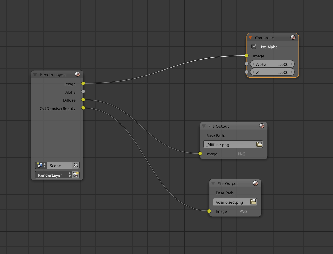

Grimm, the only option to save denoised animation sequence is to use Blender's compositor where you can save all defined render passes.

grimm
Posts: 1332
Joined: Wed Jan 27, 2010 8:11 pm
Location: Spokane, Washington, USA
Thanks JC, so I'm assuming that this is a Blender issue then?
Linux Mint 21.3 x64 | Nvidia GTX 980 4GB (displays) RTX 2070 8GB| Intel I7 5820K 3.8 Ghz | 32Gb Memory | Nvidia Driver 535.171
J.C
Posts: 1887
Joined: Thu May 13, 2010 6:35 pm
Location: Wrocław
It's not an issue. This is how it works in Blender, weather you use Octane or Cycles.
CPU – i9 13900KF, 128GB RAM, GPU – RTX 4090
System – Windows 11
My Behance portfolio, Blender plugin FB support group
grimm
Posts: 1332
From what I have found it looks to be a bug with the plugin. The plugin should be adding the Octane passes to the preview pass type menu. The one I was selecting was the Cycles pass, which is not available, so I'm assuming that Blender just choose the combined pass by default and saved it instead. You shouldn't have to use the compositor to output the denoised images.
