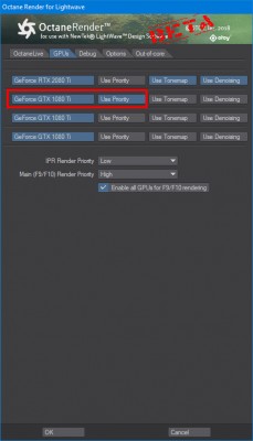

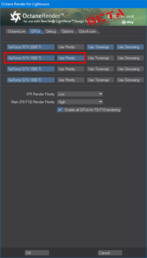

is There maybe chance that Low Priority button/feature is broken in Octane 4.x (or just plugin ??).
I'm using v4 RC6 and regardless of this button being ON for my display GPU i cant do much of work or even WEB surfing while Display GPU is rendering. Playing video on yotube stutters like crazy and skips frames, cursor movements aren't smooth and overall it seems that it ignores priority button completelly?
Juan/OTOY Can you please check it is it broken or so ?
I don't have those issues with Octane 3.08, there priority works fine and i can even work in Photoshop while rendering with priority ON for Display GPU.

The priority settings seem to work fine here using our latest internal Octane core. Be aware that after changing the priority, tonemap or denoising GPUs settings you must restart the IPR rendering closing the IPR window and launching it again to apply the changes. Reload the scene is not enough ...
