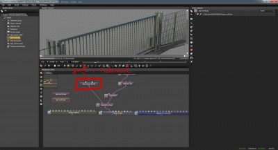

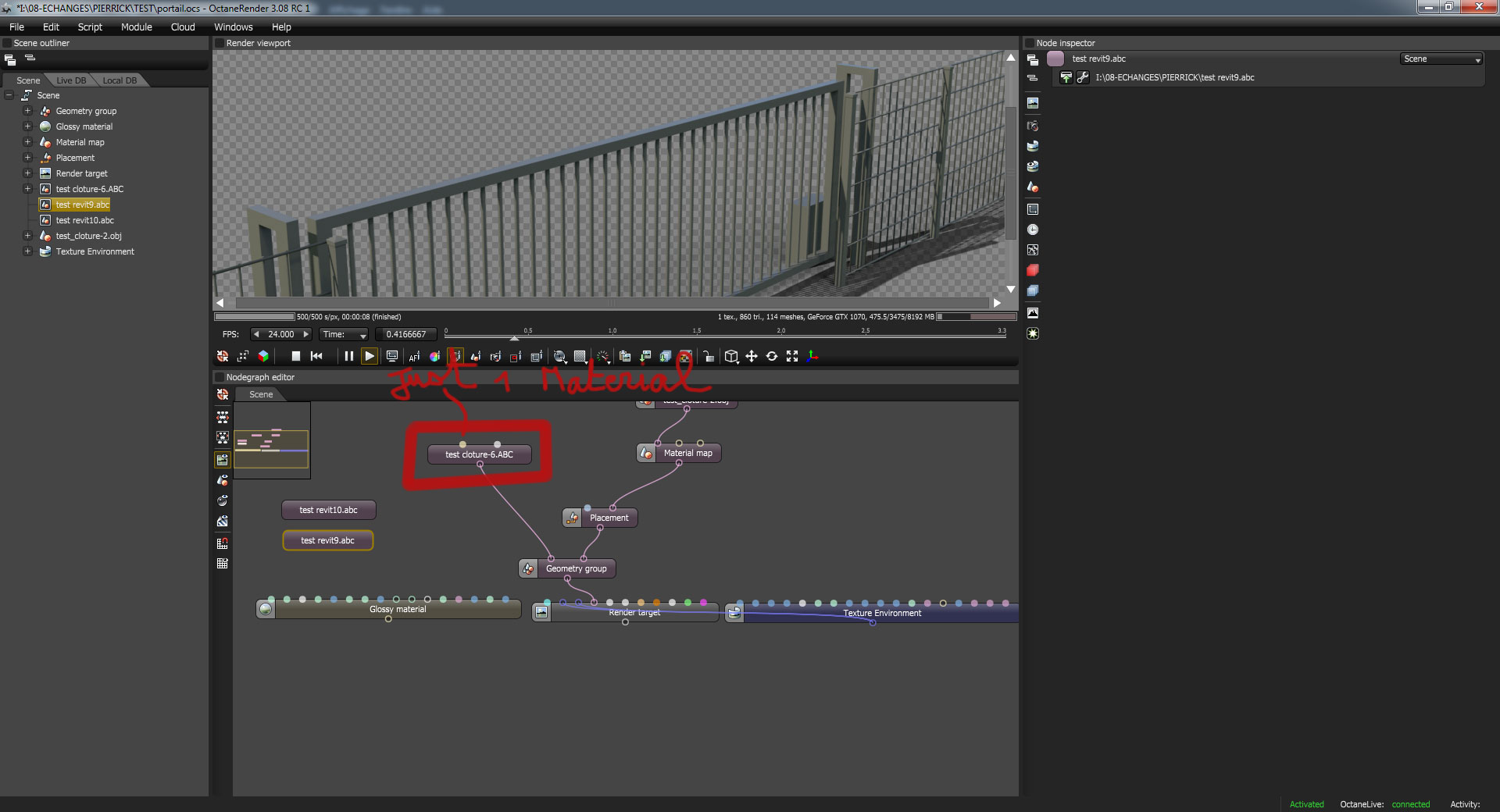

I am beginner on 3dsmax, I would like to export a video by exporting to the alembic file, but when I import the file I have a link pin for the materials.
I do not have the 3dsmax plugin.
can you help me?
what is the best method. I would like to have all the materials and the camera on the ABC file

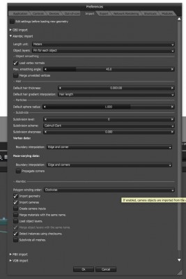

Hi Interfaces,
you should set Octane import ABC preferences according to your needs.
Try using this setup.
Regards

Hi, it works now
thank you very much ;)
