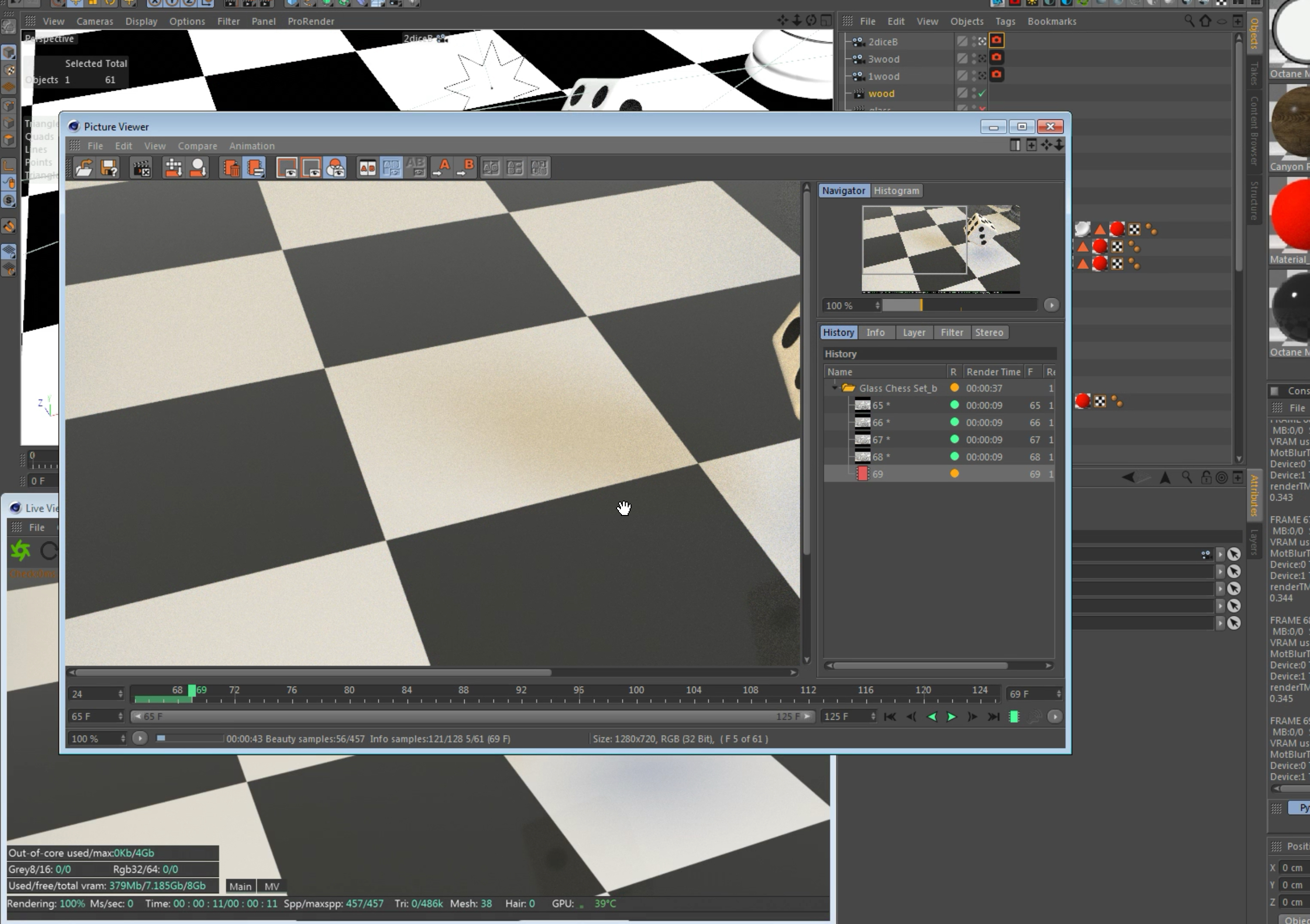

render out blank screen when using stage
clarkx
Posts: 15
Joined: Sun Nov 20, 2016 11:55 am
working on rc7r2,3x 1070 411.63
i use stage to make montage inside c4d
but some cut suddenly go blank...however liveviwer is fine
this issue also appear on stable 3.06,3.07
video
https://youtu.be/Ugw50lU5W6Y
is there any solution?
https://drive.google.com/file/d/1wiTOJ6 ... sp=sharing

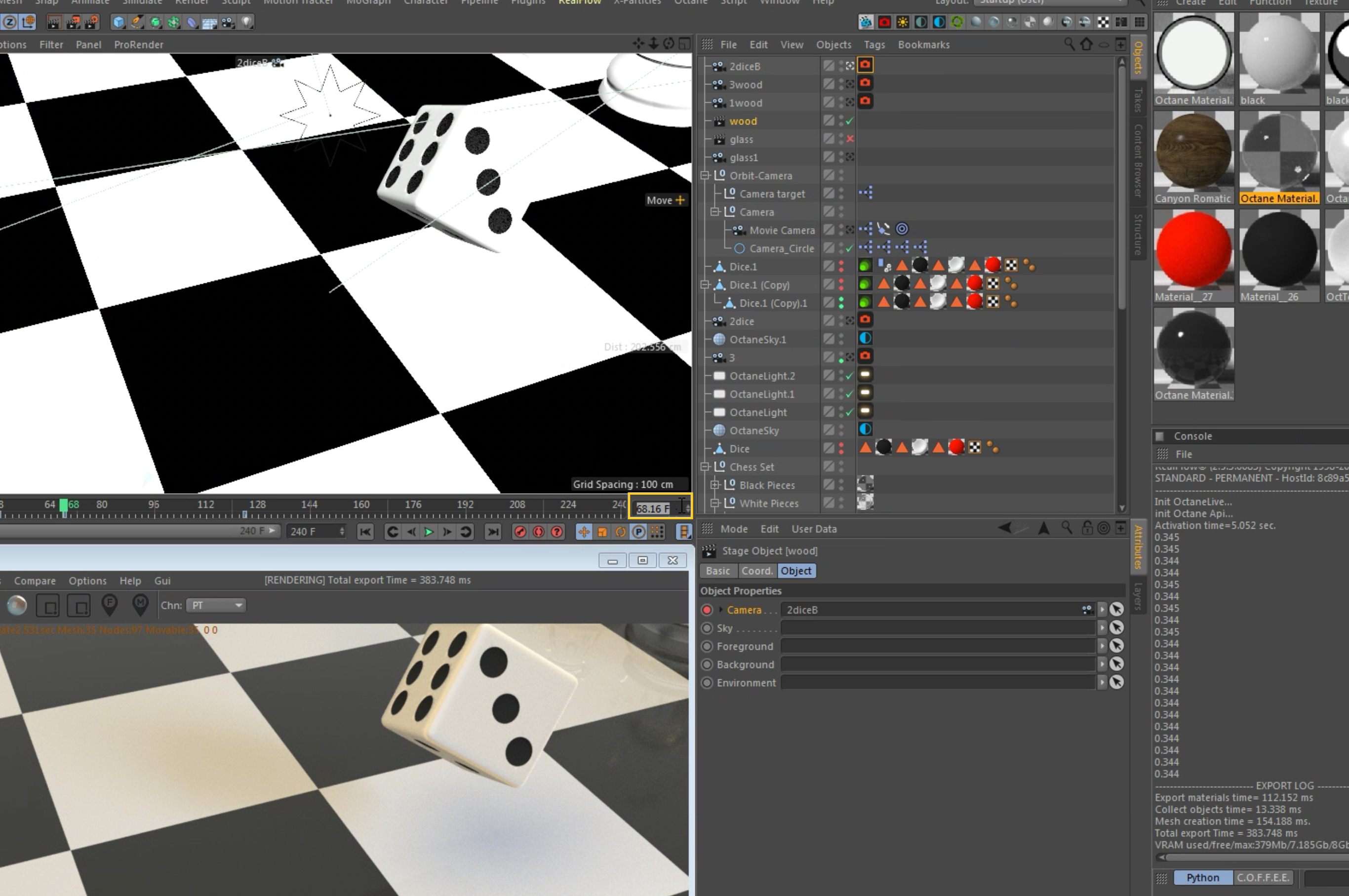

Posts: 10598
I had to find the correct keyframe at 68.16f, and create a new Octane camera, to replace the current keyframe and correct the scene:
glass chess set_b.zip
(5.93 MiB) Downloaded 136 times
ciao Beppe
clarkx
Posts: 15
bepeg4d wrote:Hi,
ciao Beppe
OH!! thank you very much,maybe i changed framerate after set up the stage
