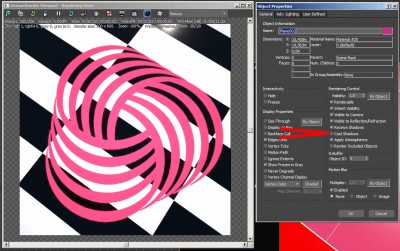

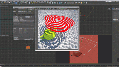

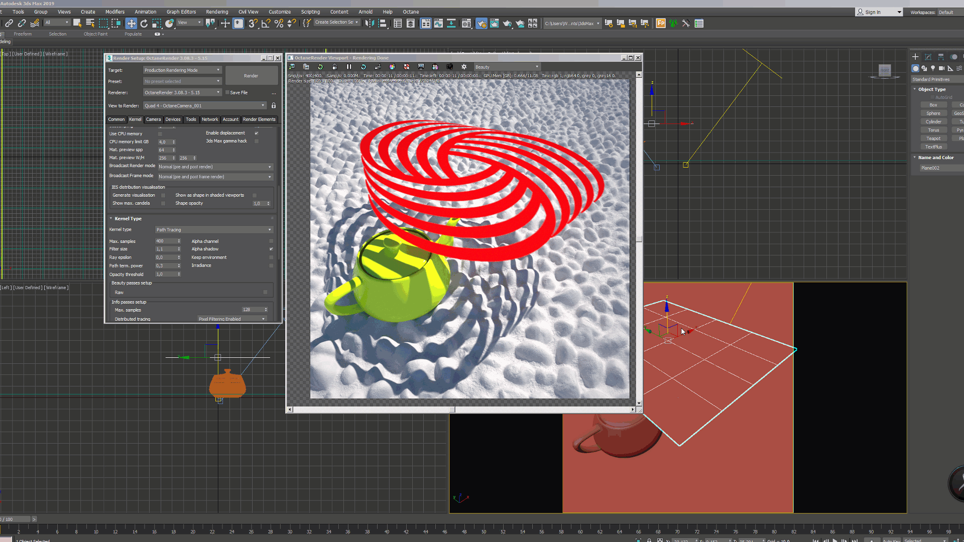

paride4331
Posts: 3862
Hi lunarstudio,
it should be works as in my clip.
Regards
Paride
