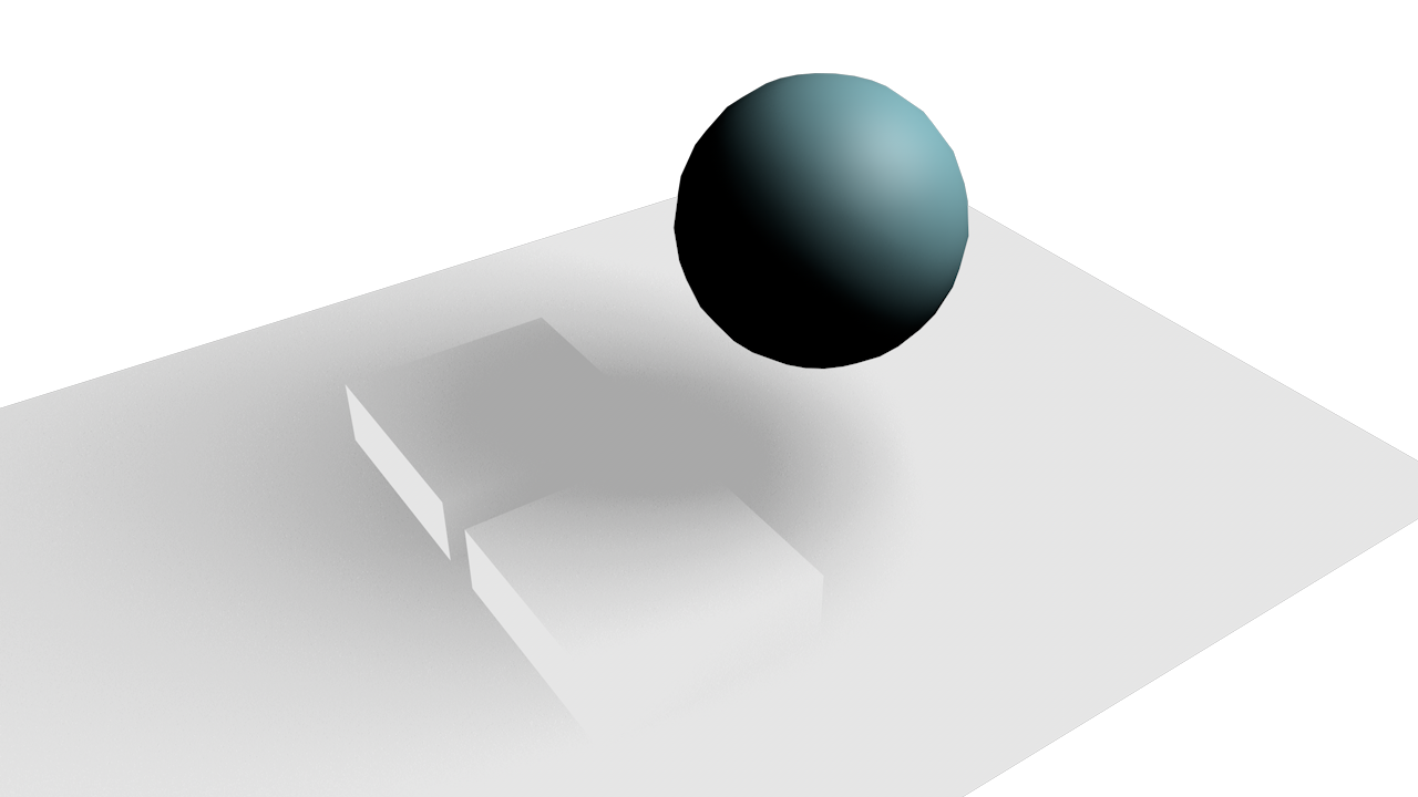

this currently renders as this, where the ground objects are also casting shadows:

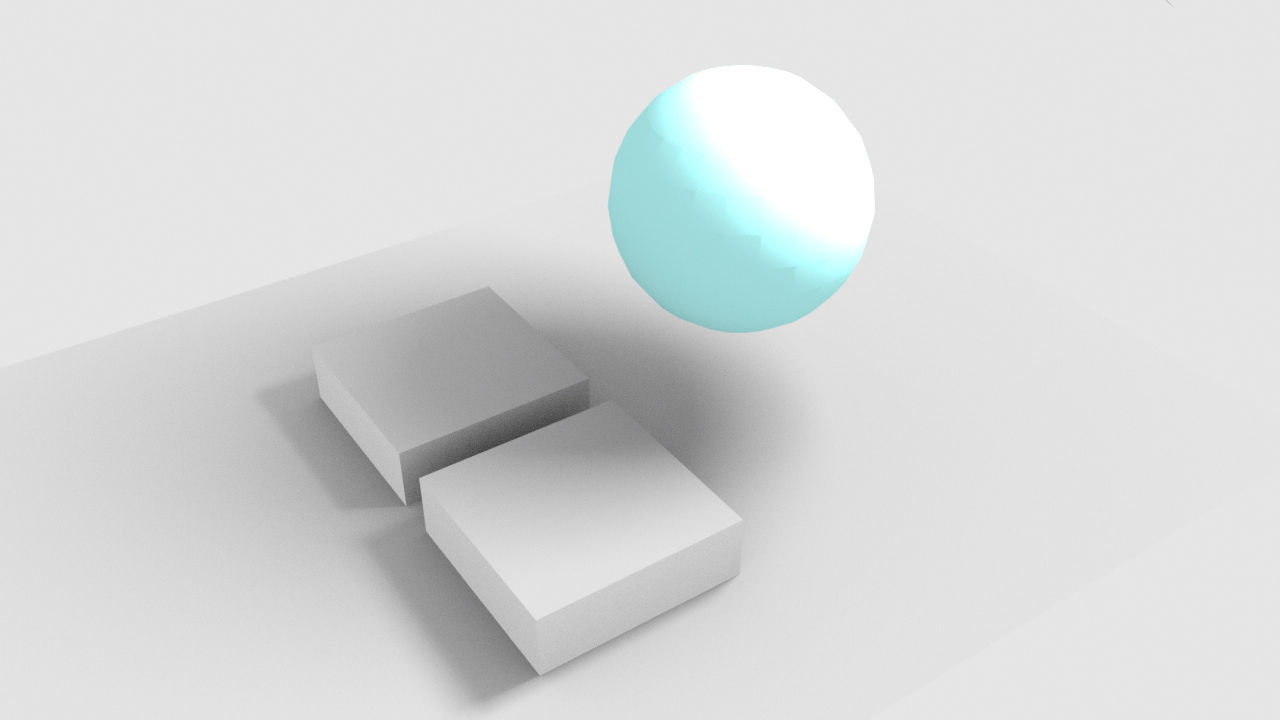

what I'd like to achieve is this, which I set up in native, where the ground objects are only receiving shadows and not casting them:

mmm, I think that it is not currently possible to do this in Octane without multiple renders, sorry.
