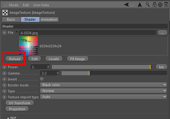

Trust me, I'd fare a lot worse than you. But yes, agreed on the bullet points of what it should be able to do. To chime in, yes, the least we'd need for Cinema would be an Octane equivalent of the 'Reload all Textures' button below:
That'd save almost all my problems for now.
