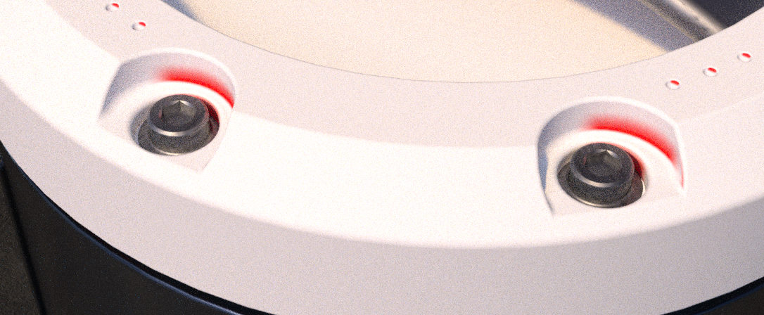

I can't seem to get the dirt node to work together with the triplanar. It only seems to project on one plane. Is this a known issue or shortcoming? (OctaneRender 3.08.3 (3080300))

Ok I think I figured it out. You have to feed the triplanar texture into the mixtexture node instead of feeding the mixtexture node into the triplanar node.
