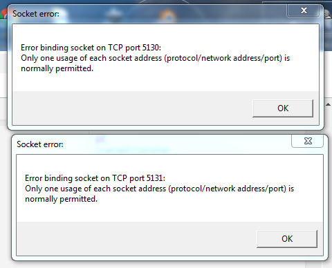

Maybe I inadvertently changed some setting?, but Error Binding Socket alerts are showing up (usually behind the Blender application - so I am not aware of them
until closing the ap).
Thanks for your help

I can confirm this behaviour in your file (I don't get the Error Socket Message).
But this behaviour seems to be related to your Blender "Default" Screen Layout only.
Switching to "Animation" or "Compositing" Layout fixes the issue.
