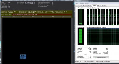

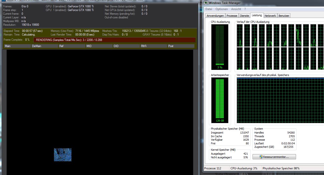

Is there some issue in this build with big resolution renderings in conjunction with ram usage?
I´ve to render a 19.000 px image and RAM gets very high (125GB) while "updating Scene in GPU"
GPU memory is still some free (see attachment) and Out of core is disabled.
After rendering with limited region it seems that denoising does not work. :( But i do not get error message.
Thanks a lot :)

Some further test. When i deactivate denoising. RAM goes "only"up to 71.8 GB while" Updating Scene in GPU"

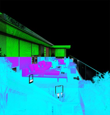

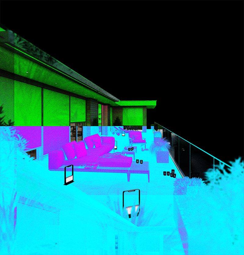

There are no instance objects on the same place. I´ve carpet instances.
When i reduce the final resolution (12000x 12000) the RAM is about 89.5GB. Still very high but i think this could be
not the reason that my Denoise Pass is always damage. See attachement.
With abut 3000x3000 (RAM usage 42GB) everythink works fine with Beauty and Denoise.

After testing and deleting object after object at the end of the day iam ending up with a scene with a cube which needs about 60GB of RAM
and gives with a 12000 px resolution a damaged DeMain Buffer Output. With strange color like upper example.
So i hope this is a good test scene for bug fixing. See attachment
Greetings

Hmm, in any case, I think that the main problem here is that the denoiser resolution is limited to around 4k currently, as far as I know ...
Thanks,
-Juanjo
