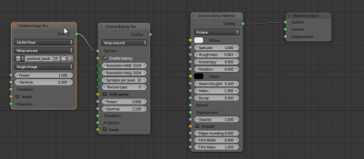

Baking texture is compiling itself even if it is not connected to the material that is connected to material output. This make every change in the material longer than necessary.

Hi J.C,
Do you mean the following situation?

Yes, exactly.
