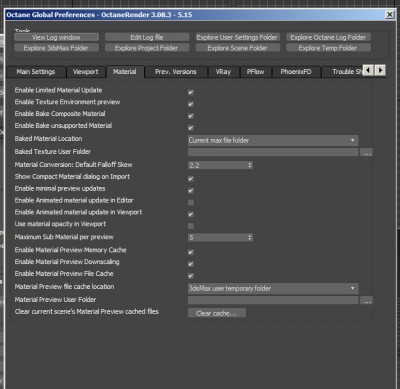

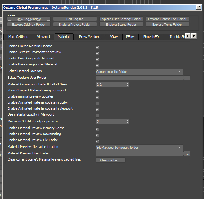

Hi thekwen,
never heard this before.
Did you check if your disk system is full?
As I can see in your screenshot your temp files and maybe all the backup, swap and temp folders are in system disk, this could make 3dsMax crash.

Hello Paride !
I have 60GB free on my system disk.
The saving errot "seems" (tried only one time after crash on saving, i redo the same but close material editor before save) to not happen when i close material editor before saving.
Waiting 10s for material editor to respond is a pain in the ass but so much crash while using it is a huge problem for me.

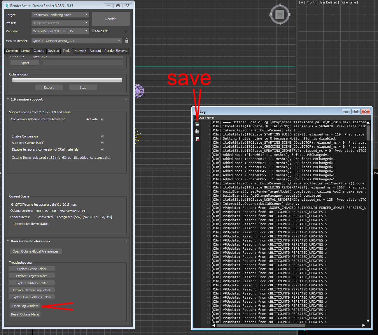

Hi thekwen,
could you share your global settings file:
C:\Users\(YOURNAME)\AppData\Local\Autodesk\3dsMax\2018 - 64bit\ENU\plugcfg_ln\
and Octane Log Windows after crash (Render setup > tools > User global preferences > open Log Windows > (save it)
Regards
Paride

Hello !
CFG file in attachment.
For octane log windows when max crash it close log window ... how to save it ?

- paride4331
- Posts: 4004
And for information, log windows does not give any information while i'm working:
I open my scene
i open log window (octane version appears)
i open material editor
i create a glossy shader
max crash
nothing appears in log window and it close.
Max cause log window to close when crash i can't save it after crash ...
Kwen
I open my scene
max crash
Kwen
- paride4331
- Posts: 4004
Hi thekwen,
after crash but before re-open 3dsMax
copy Octane3dsMaxLog.log
C:\Users\(YOURNAME)\AppData\Local\Autodesk\3dsMax\201X - 64bit\ENU
Regards
Paride
Regards
Paride
