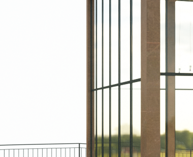

hi guys, iva a problem.
Use hdri for enviroment e lighting and save in png or tif with alpha.
alpha map works fine but the hdri is visible in glass windows.
need to have a glass in alpha witout hdri...
if open png in photoshop can see that enviroment out of windos is ok but into the windows see it!! :oops:
it's possible it?
thanks for help :)

Have you tried to enable the "Affect Alpha" option in the specular material?

juanjgon wrote:Have you tried to enable the "Affect Alpha" option in the specular material?
Thanks,
-Juanjo
yeah!!! perfect!
thanks <3
