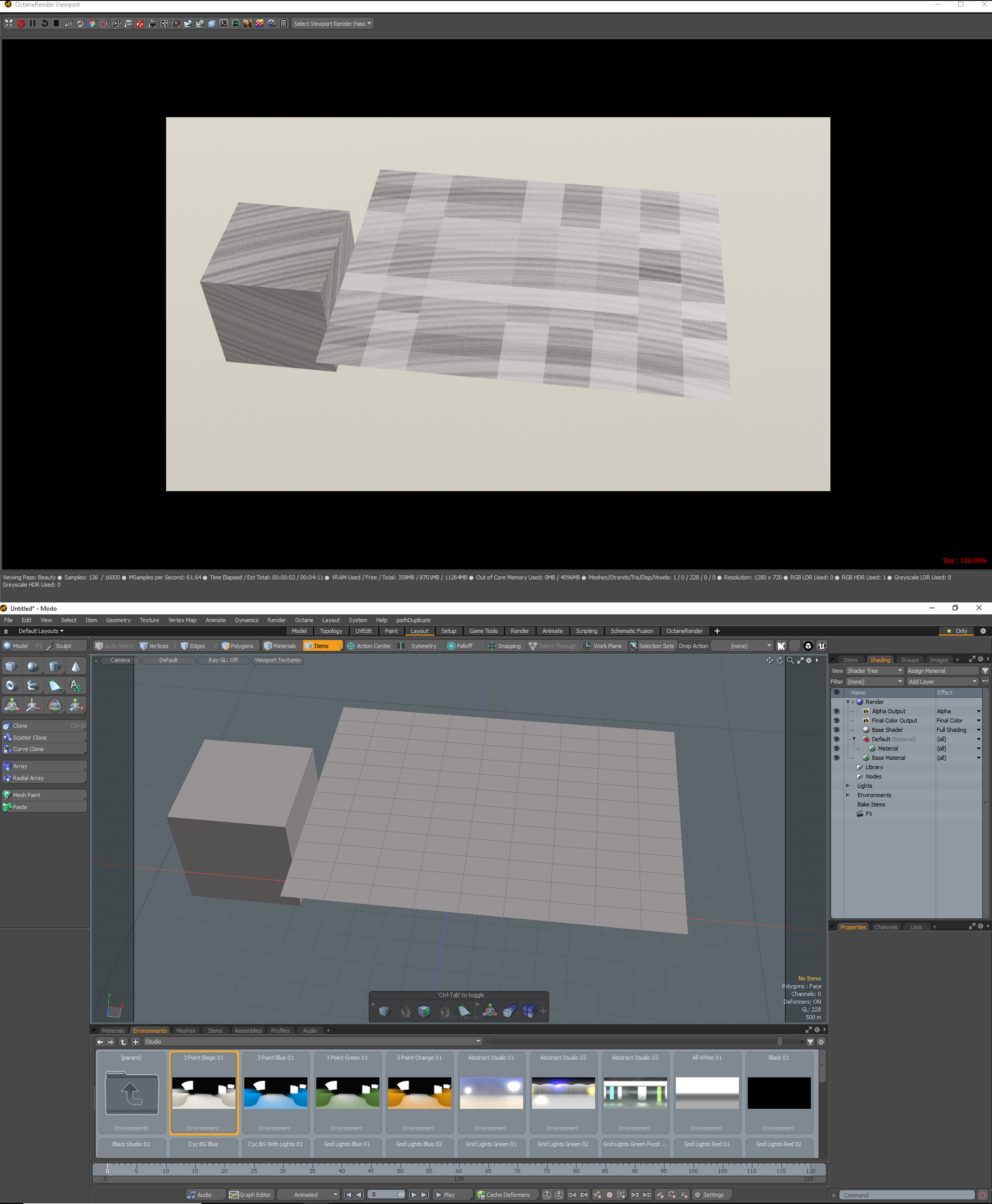

So I've been experimenting with the Octane plugin for Modo and recently I've been getting these weird patterns in my renders that just aren't there on my meshes. I've never had this issue before until tonight. Does anyone know what the issue is here?
Any helps is appreciated.

It is either due to the plane being on the 0.0 Y coordinate (try transforming the geometry up a fraction to test this), or the Ray Epsilon needs adjusting.
