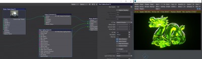

I thought that plugging a black texture node into the visible environment while putting an HDRI image into environment would let me use the HDRI to light the scene while keeping the actual render a black background.
This is not the case. The HDRI shows up regardless. Am I missing something?

Disabling the "Keep Environment" option in the kernel node should help to get a black background.
