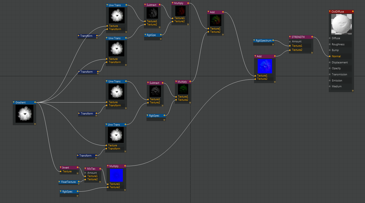

I have this proof of concept node graph for now. If anyone (that has a loving relationship with vectors) wants to give it a shot and turn it into OSL that would be sweet. The method is from here.

milanm wrote:I've been looking into this. I'm going to post a OSL node for correct layering of normal maps soon-ish here on the forums so I thought about including this functionality too, we'll see, I can't promise anything. ;)
Orbx:
BumpToNormal.orbx
C4D:
BumpToNormal.zip
Cheers
Milan
Thanks for your approach Milan! I checked your file and it works just fine, but lacks some options. The good thing about Knald / Crazy Bump is that they have some mixing option between different radiuses/sizes of bumpiness. I usually do some text embossing with those programs and reflections works really well after mixing. I think its really easy to implement to your concept tho. You "just" need to mix few offsets and blurs together, but it will be spiderweb node system, so approaching that via osl would be great!
Keep on going, and thanks again.

@Jolbertoquini
Hi
The setup is in my first post above. Inside OctDiffuse node. There is also a link about the method.
My second post is just an old idea from Beppe originally that is still technically a better alternative to offline apps (paid or free) in terms of quality.
In the meantime Mads Drøschler posted an OSL script that uses that same method and it could work just fine in Octane with some small tweaks.
I don't use Facebook, so if anyone would be kind to ask for permission from Mads via OSL Shaders public group to make an Octane version of that shader I would be glad to help right away. It's a separate repository than the official one from Autodesk and I'm not sure if it's covered by Apache 2.0 license (whitch would be great).
Here is the relevant post: https://www.facebook.com/groups/OSL.Sha ... 150856077/.
EDIT: Never mind, I wrote my own script in the meantime. I will post a link here. If the one from Mads becomes available under Apache 2 I will post a version for Octane here.
