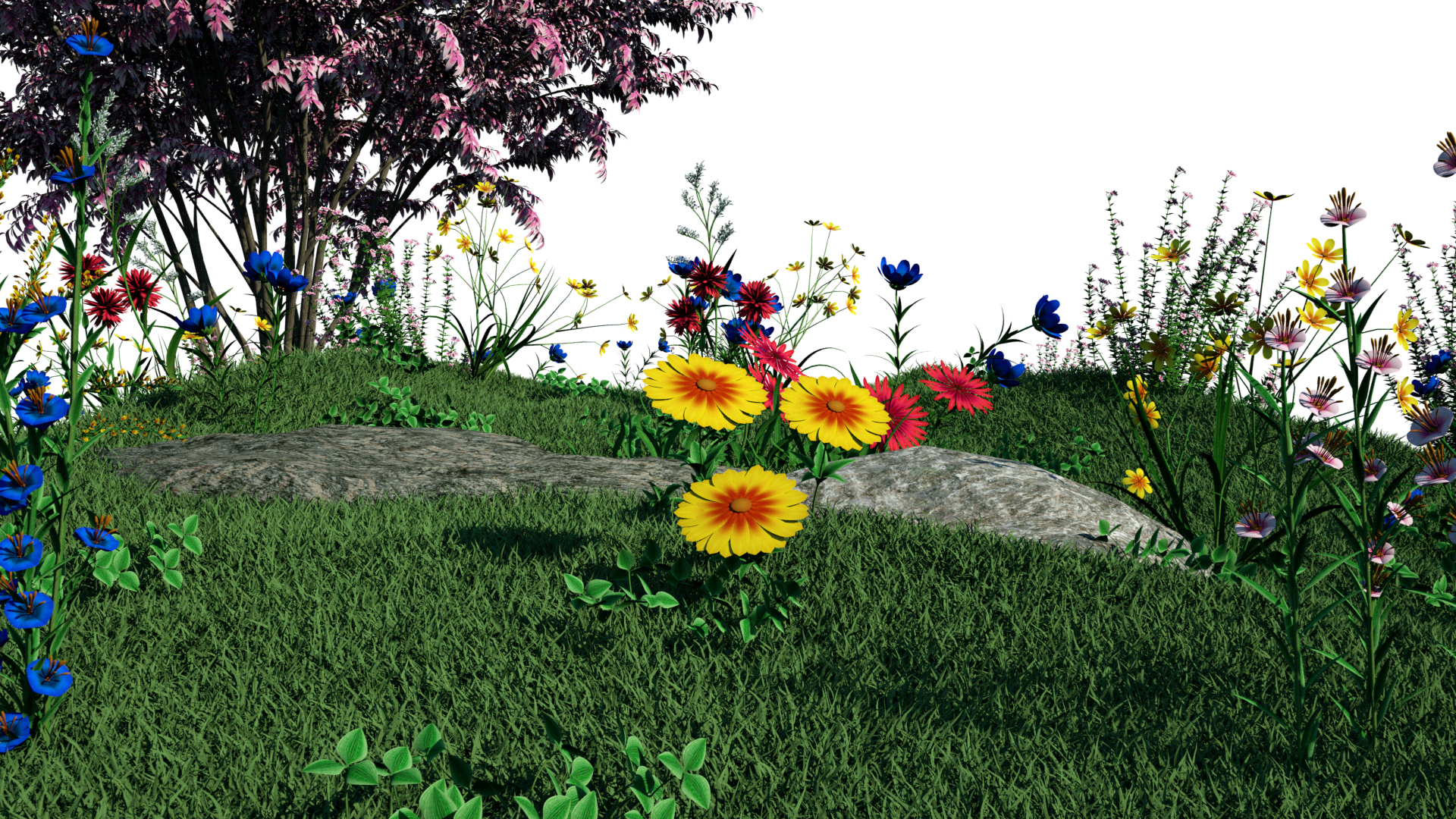

Please send me your scene so I can test here! Write what's forester/octane and c4d versions.
If you need you can drop the tree and the grass if this exceeds your memory.
Forester 121 will render this as is, going up to about 57% memory usage then dropping to 40% during render. Forester 143 uses up all memory and crashes. In fact all versions of Forester past 121 crash.
Tested here on C4D 19.068 Octane 3.08.3. Windows 10 ver1803, 32gigs ram, i7-5960x, 1080ti and 1080 on same system.
But it has been test on all previous versions back to 3.0.6. and all C4d back to version 17. Same problem, along with other video cards and earlier versions of Windows 10.
I password protected it since there are some textures I wasn't sure if I could distribute. Can I dm you the password?

Hello,
The scene renders fine in the latest Forester, in fact faster than the older version 121.
What I did was reduce the branch segment count from 18 to 10 and branch sides from 8 to 7. Rendering the same scene on the older 121 consumes more memory.
Memory consumption started at around 30% and finished at around 50%
If you wish to discuss this matter further please get in touch with us by email.
