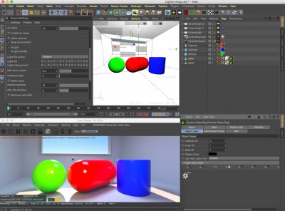

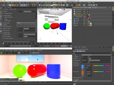

Posts: 10626
have a look at this simple example scene made with v4RC4 Mac:
lightlinking.zip
(261.78 KiB) Downloaded 347 times
Let’s say that we have a scene with three objects inside a room with a glass window, enlightened by the Daylight environment, and three different Area lights:

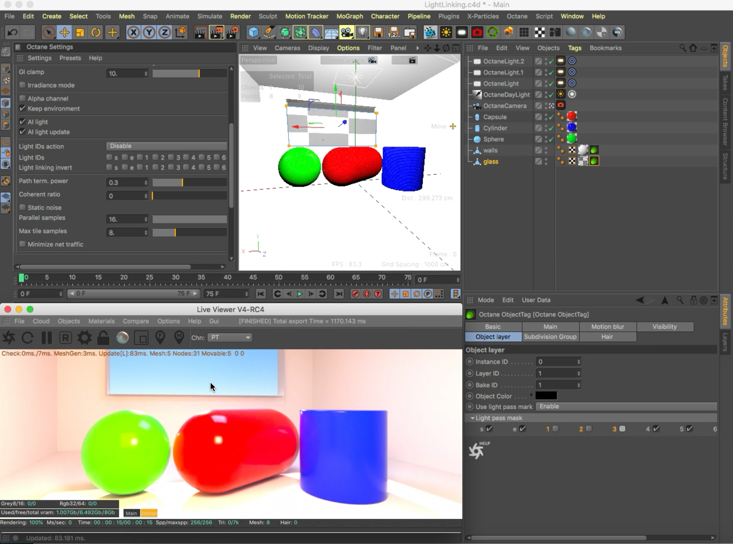

We don’t want the reflection of the Area lights on the glass/window, so we add an Octane Object tag, we change the Use light pass mask option to Enable, and we untick the #1, 2, 3 checkboxes to disable the effect of the Area Lights on the glass:

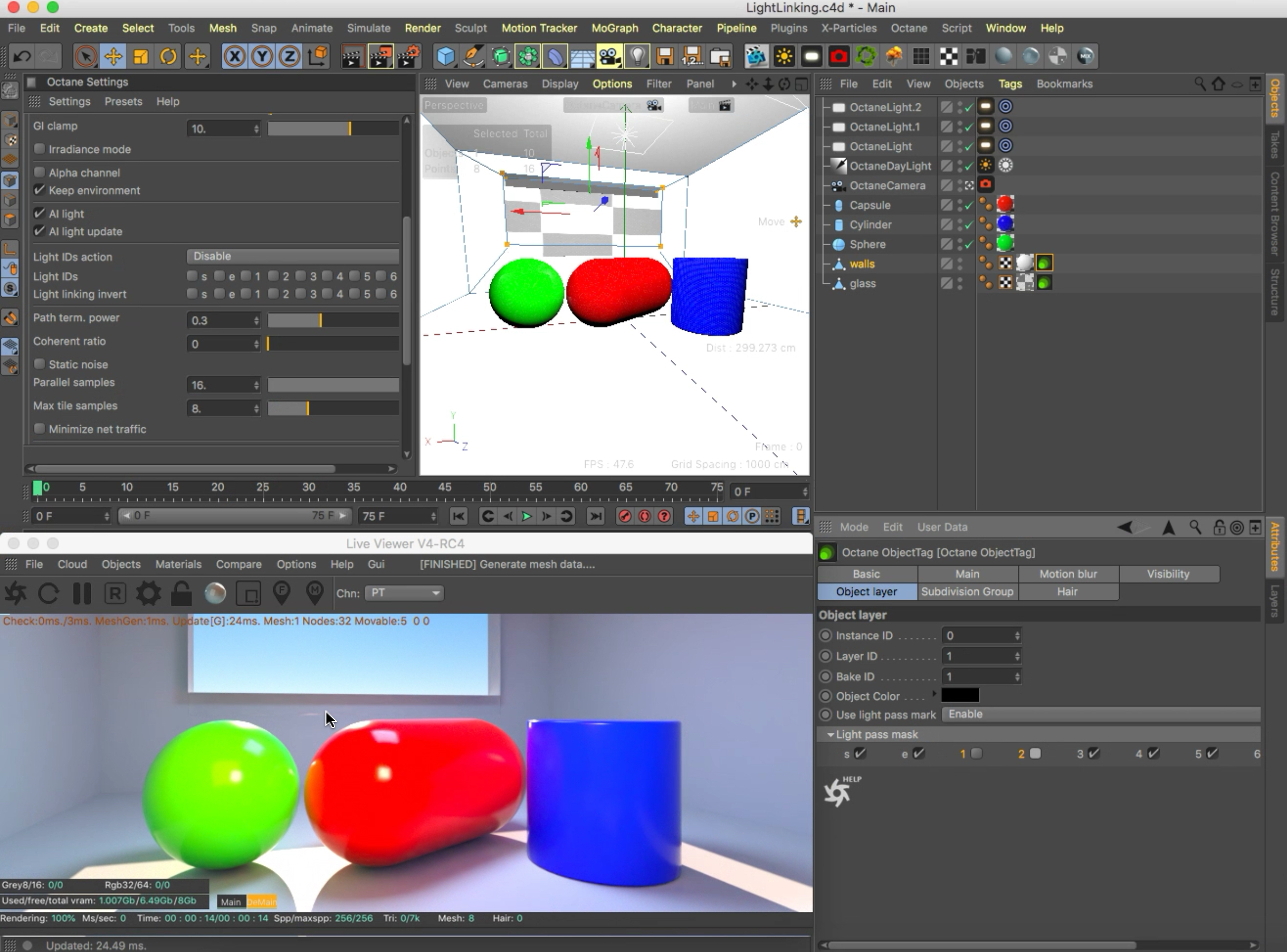

Then we want to have the room enlightened only by the Sun/Environment, and the Area light on top #3, so we add another Octane Object tag to the walls object, enable the light pass mask, and untick Light ID 1 and 2:

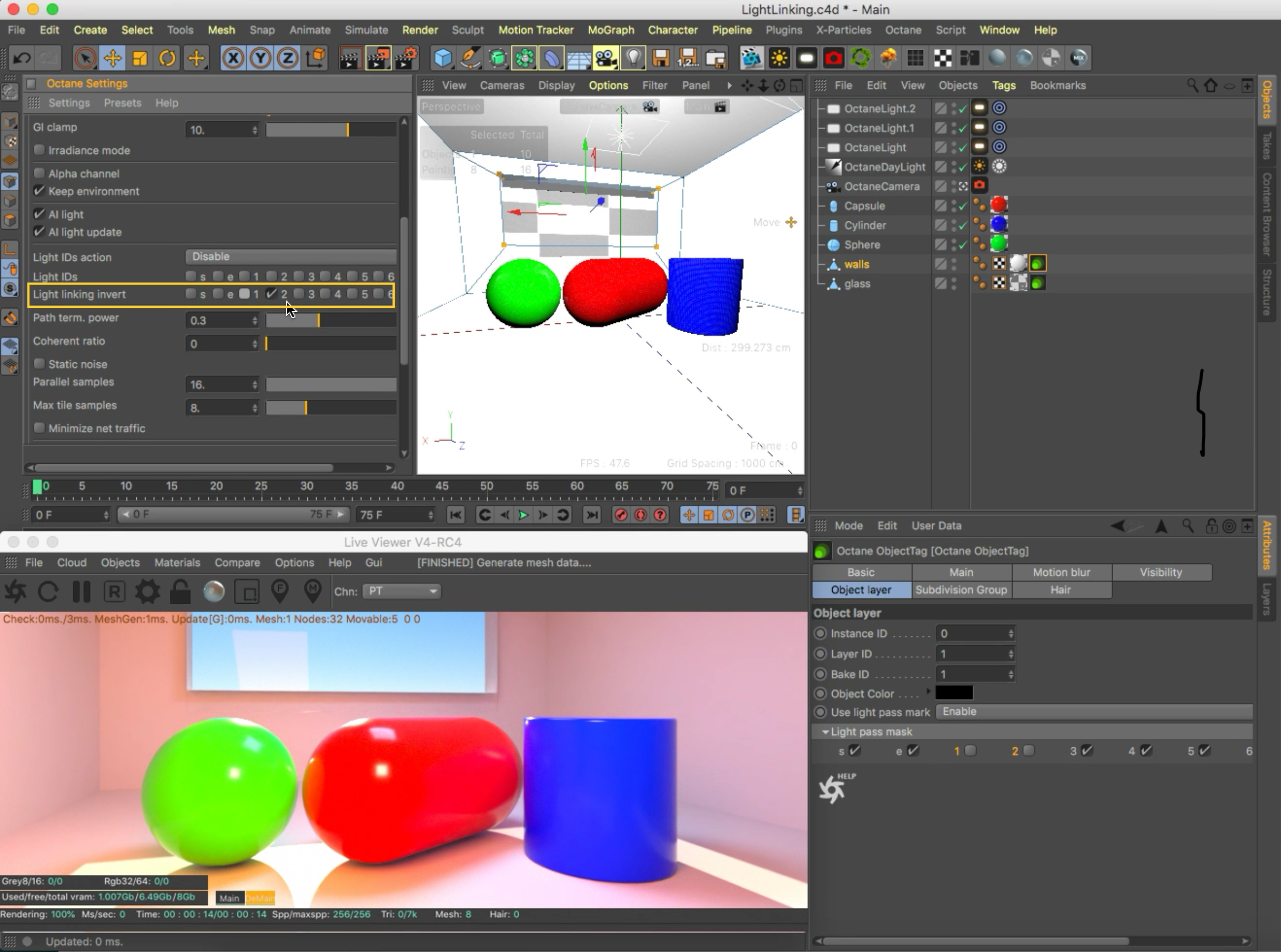

In v4RC4 you can also use the new Light linking invert option in the Kernel setting to invert all the light linking tag at once, for example by enabling the Light ID2:
