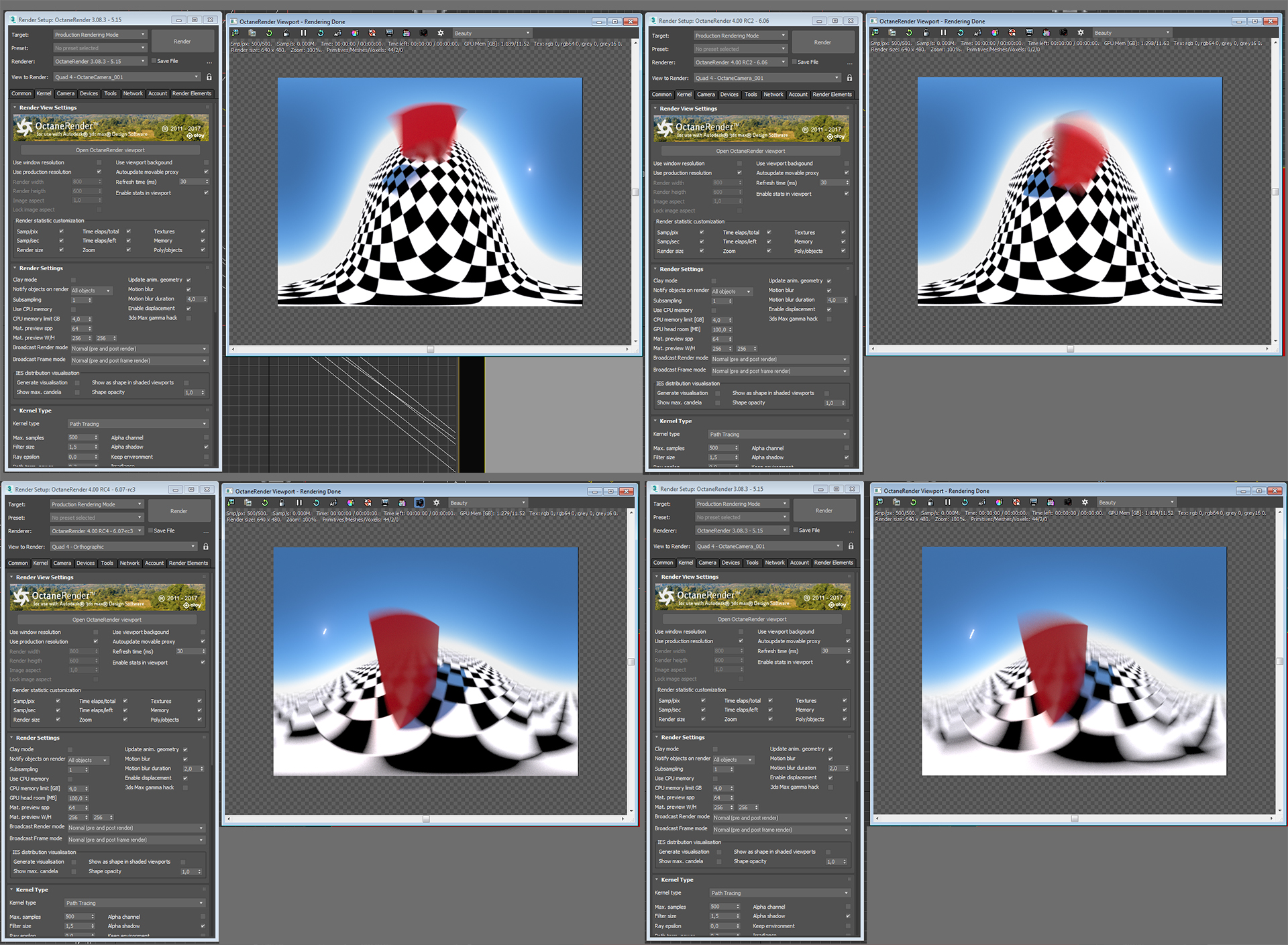

Here's what happens when i go from standard to spherical camera:
Thx
thekwen
Posts: 109
Joined: Sat Jun 01, 2013 2:26 pm
Ok i found the problem,
When you check "Keep upright" in camera option, there is no motion blur anymore ...
