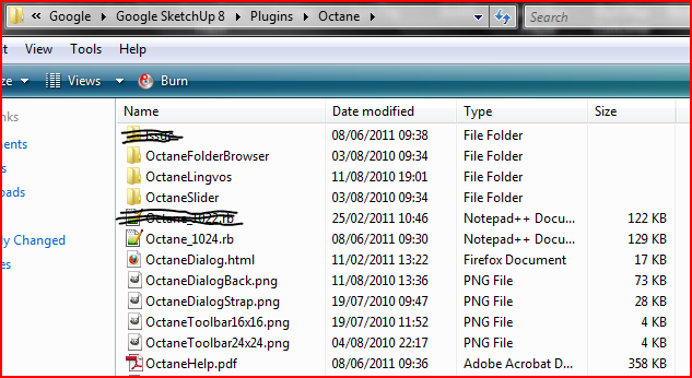

Can you take a screen shot of your ../Plugins/Octane folders - here's what it should look like
[Note I've struck-through an extra folder that I have, and the older octane...rb file that you may or may not have [unimportant]]
There should also be a Octane_loader.rb and deBabeleizer.rb file in the ../Plugins folder itself...
You do have full access-rights [permissions] to your Plugins & Octane folder ?
I trust there are no 'Compatibility Files' issues - e.g. some files are not really in Plugins ??
