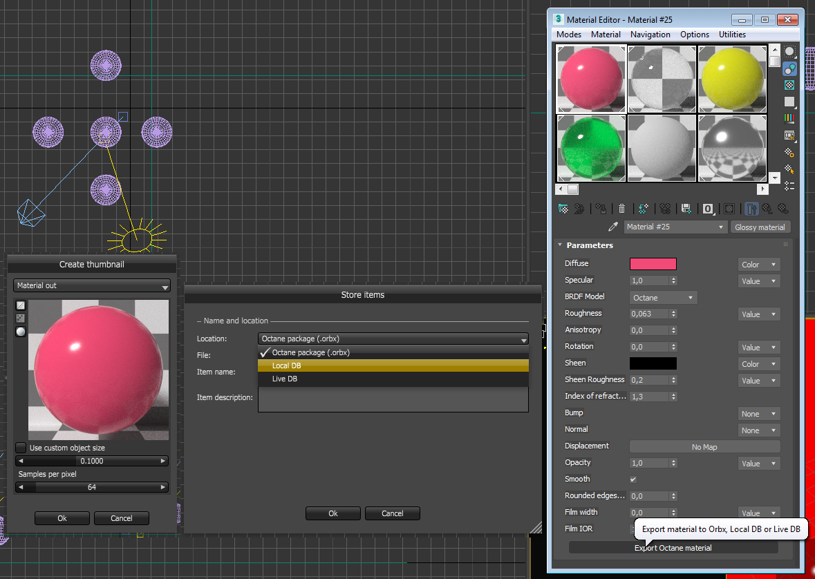

due to the recent Autodesk subscription and pricing politics, I am currently thinking about moving from 3ds Max to C4D (or maybe another modelling software). Therefor I was wondering if it was possible to export my Octane materials or even my whole material libraries from 3ds max, so that I can import them into any new octane-plugin of another modelling software like C4D? And if so, how would be the correct way to do so? It would save a LOT of time not having to re-create the materials. :?:

you can export your Octane material to LocalDB and use it in SA or in the plugins you want.

thank you for your answer, I will try your way later, sounds very good. I'm sure that was, what I was looking for.
