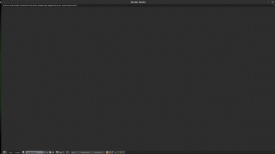

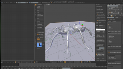

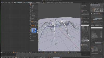

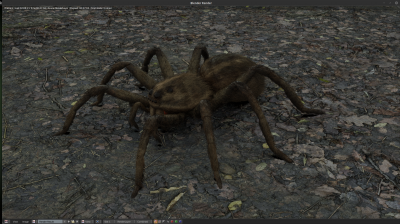

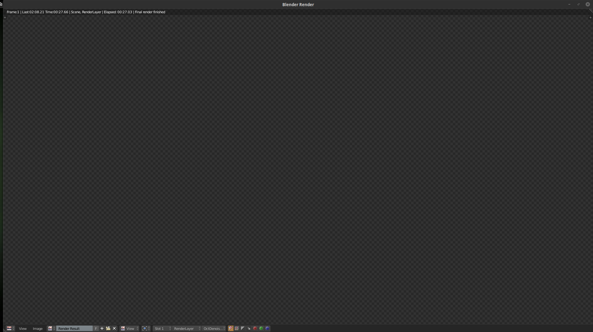

Hi Drawfun,
Thanks, but I have all of those settings set and still no denoise. Here is how I have the options set:
I then do a F12 render:
You can see that the pass menu is set to "combined", if I change that to "OctDenoiserBeauty" I get this:
I must be missing something somewhere?
Jason
Jason

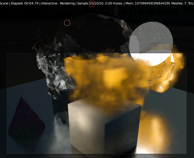

Hi Drawfun, grimm, the samples at first position marked in your example image never change, it always stay at 0.
May easiest way is to upload a small example .blend with a correct setup.
Cheers, mib

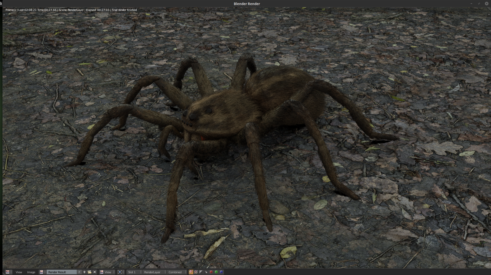

Thanks Drawfun, it's working better, but still not quite right. If you have the "Display" in the "Render" properties set to "Image Editor" it appears to work fine. If you have the display set to "New Window" it doesn't work and either just gives you a copy of the beauty pass or a blank white image. I tested this with the other denoising passes as well. Also the denoise is very slow, the render finished in about 27 seconds, the denoise pass in about 1 min and 45 seconds.
Setting display to "Full Screen" and "Keep UI" works, just the "New Window" fails which is the setting I like best.
Jason
Jason
Linux Mint 21.3 x64 | Nvidia GTX 980 4GB (displays) RTX 2070 8GB| Intel I7 5820K 3.8 Ghz | 32Gb Memory | Nvidia Driver 535.171
Thanks Drawfun for looking into this, I'm not sure where the issue is? I just did more tests and it appears to work fine with newer blend files. The scene with the spider is fairly old and It has these issues. When I tested the spider scene again, the first render displayed an image for the denoise channel but it was just a copy of the combined image. I did several other renders and the denoise image was just a solid white.
I also saved the scene and reloaded it, but it still has the same issue.
Jason
Jason
