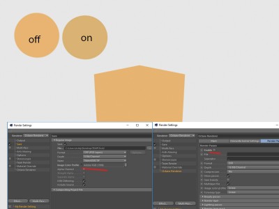

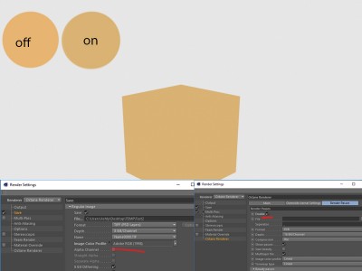

I've been outputting my main image with a color profile of Adobe RGB (1998) loaded into the save settings. Everything works correctly and looks correct on export until I turn on Render Passes. When Render Passes is turned on the color profile I have loaded is ignored (seems to be reverting back to sRGB instead). When I inspect the exported render in PS it is tagged correctly as Adobe1998 but the colors are incorrect and look like sRGB output instead.
Octane V 3.08.3
Windows10
Main output ignores profile if render passes is enabled

Savings the main output is not handled by the plugin. So you should have a different reason.
As I said that we don't handle the main save section's color profile in any ways. It's handled by C4D system.
