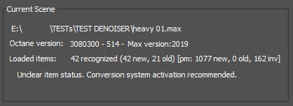

I made a scene with 5.014 and open in 6.05. In Octane render setup window I get this (see pict ). What that it mean ? Thanks

when loading very old (<2.0 ) scenes, that had material not loaded correctly (all grey)
When Activate V1 Support or Enable V1 Scene Info are enabled, Octane checks the parameters of all materials, searching for 'old' ones.
