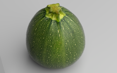

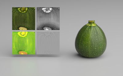

i build myself a photogrammetry rig which let me capture a diffuse and a specularmap. I also tried to seperate a SSS Map from the diffuse texture.
The Models were made from 1356 Images focus stacked to 226 sharp images and then processed in Agisoft Photoscan with Ultra High settings. Over 10 hours of capturing and 5 hours of postproduction per Model. HeliconFocus, Agisoft Photoscan, Photoshop and Modo 12 and Octane Render for Modo were used.
https://sketchfab.com/models/6bb612d452 ... 7c46b1ebe1
Let me know what you think and what could be improved.
Thanks in advance
Photogrammetry with captured roughness/reflection
Wow those look real, even the hairs on the zucchini stands out. Thanks for sharing.

Thank you very much! Since the rig is now fully functional i will continue to scan objects and post them here. If you have suggestions what to scan please let me know.

Ho do you generate the specular maps ?
Is it a specific setting when you take the photos or does photoscan generate them for you ?
Or do uou generate them in the end by selecting some specific color range and attribute them some different values ?
- Hesekiel2517
- Posts: 462
- Joined: Mon Nov 23, 2015 10:57 pm
Photoscan can't generate those maps. You also can't extract them from the diffuse texture. You have to capture additional photos with special lighting.

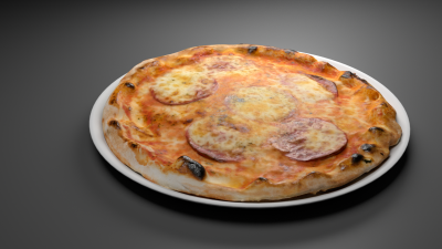

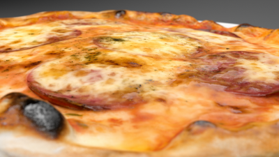

A long time passed by while i build a 3D Scanning rig. Here are the first results:
