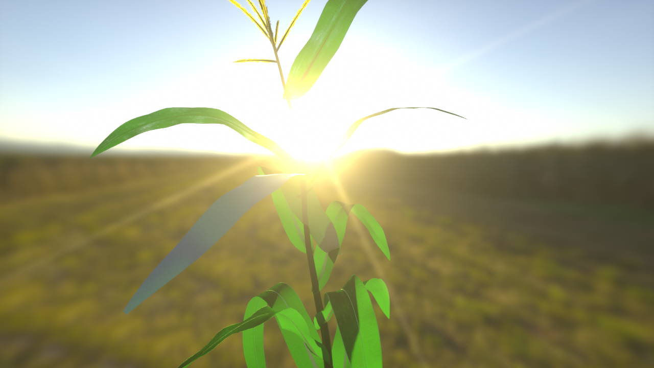

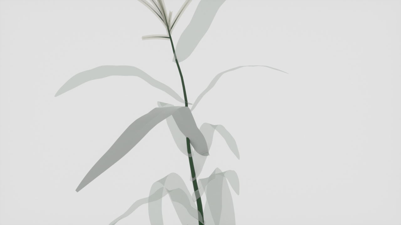

But now, and I suspect this is related to all our other issues - if I have an Octane sky pointing to an HDR (and the HDR is inside the tex folder) - when rendering between different machines, the HDR will vanish on other machines - but it will appear on others. We just get the default Octane background color, as if the HDR isn't even there.
I'm wondering if this is related to our texture issue (flickering and sometimes the materials show as transparent)
I'm going to render you an example real quick here
I attached the images.
So one machine is rendering almost correctly (notice the one leaf is grey) and the other machines just does'nt know what's going on. If I render these locally, there are zero issues. Over the network however? Disaster.
