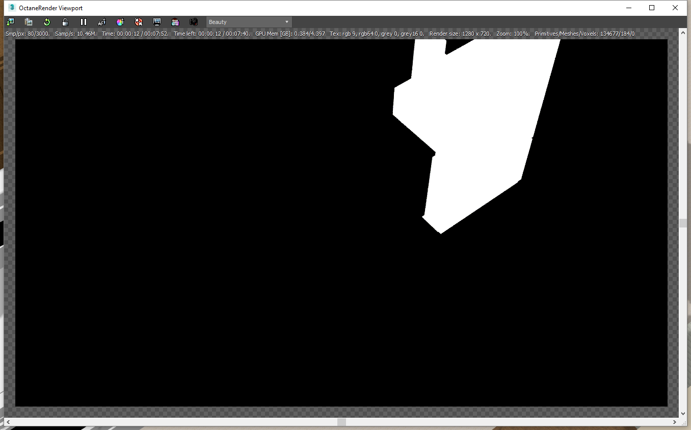

This is all I need

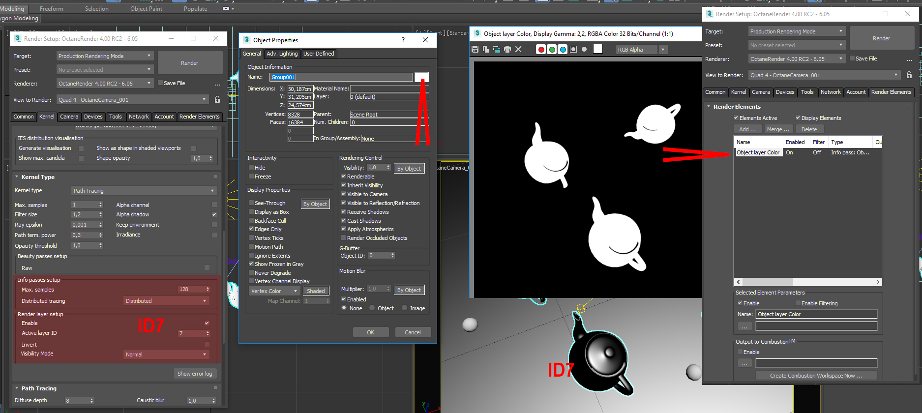

@richardyarlett
you can try this script (just a test, save scene first), and when rendered, port to max framebuffer, display alpha channel, and copy image....you can past in photoshop. (ouf)
hope Neon Z, can make something :-)
how to use : select your objects, run the script.
currentrenderer = renderers.current
currentrenderer.kernel_kernelType =3
currentrenderer.kernel_channelType = 12
SEL = selection
max create mode
for a in Objects do (setUserProp a "octane_layer_ID" 5)
for a in SEL do (setUserProp a "octane_layer_ID" 1)
currentrenderer.renderlayer_enabled = true
currentrenderer.renderlayer_id = 1
currentrenderer.kernel_maxSamples = 128

You can find something more usable here :
http://www.scriptspot.com/3ds-max/scrip ... quick-mask
