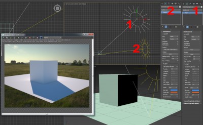

But we have a trick: you can use 2 suns as in my screenshot. you can use OctaneDaylight or HDRI and then set your backplate as you like, but it's not change your camera exposition.
You can also set reflection or refraction as you like.
I hope it helps.
