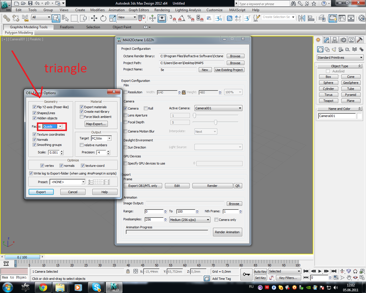

Hello! Listen, our exporter for 3d max is the worst of all, because long export...
The reason is simple .. in settings of your exporter not triangles. Fix Please!
a very long time is exported
big mistake (only 3DsMax ) ((((((

actually is set in whatever <none> is, so if you changed it then is set in quads.
Is good to check before how your settings are for the default cause even thou it changes those values if you change it back it'll keep those values instead of the octane ones

I experimented with a scene of 99 mb and triangles loaded in 4.10 seconds with cuads loaded in 2.57 seconds and 2.55 seconds polygons in this last option in the render polygons for errors, take into account that this configuration can be effective for scenes with simple polygons, but unfortunately have to use when you need presicion triangles rather than speed. I hope a version comes out soon integrated into the 3d studio because octane is great for rendering images, but the loading time for an animation makes the final is just slower than vray, or at least they can charge the full timeline and not just a frame.
