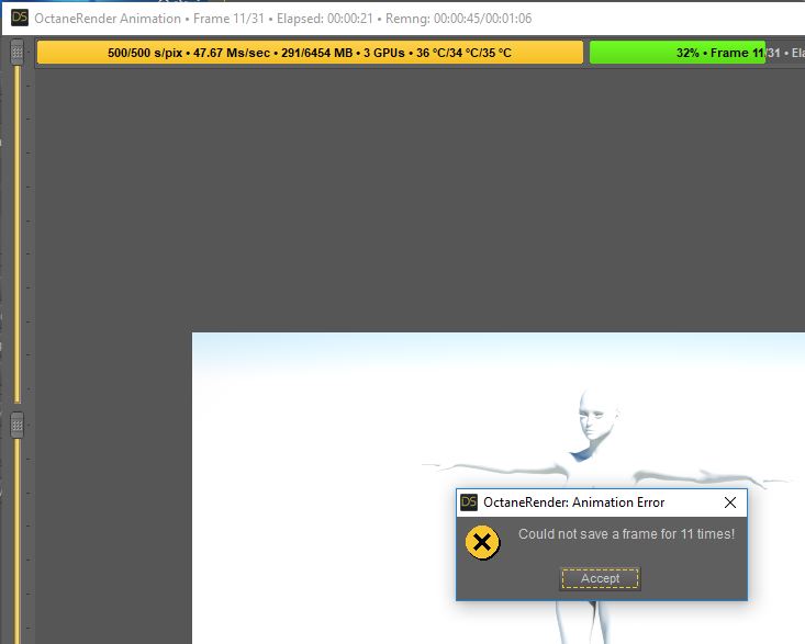

Hey Paul,
here comes an update to the problem.
I now use a Genesis 3 figure and there comes every time the same error by frame 11.
What did you mean with "an odd body part", my figures are without all any other items, only the figure.
Please see the Attachements.
Thank you for help.
Michael

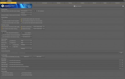

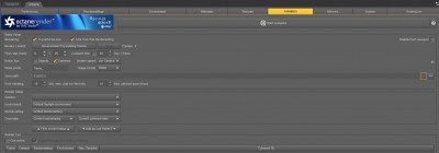

Hey Paul,
here is the screenshot, hope it helps.
Greetings from Germany
Michael
Creating Stills and Comics
https://findt.com
face_off
Posts: 15765
Location: Adelaide, Australia
Have you tried the suggestion in NOTE 3 at viewtopic.php?f=44&t=55214?
