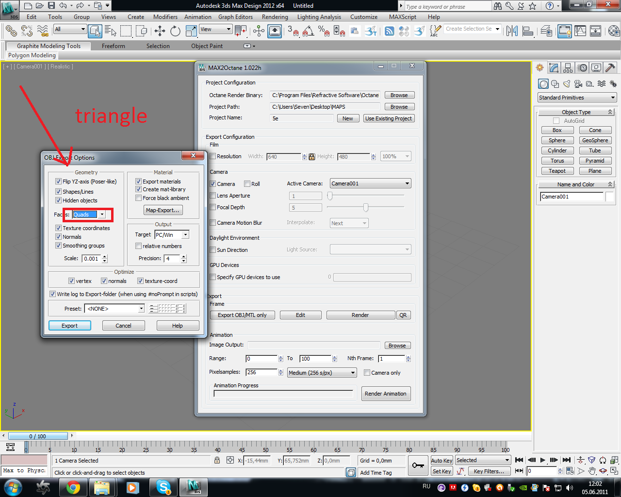

Hello! Listen, our exporter for 3d max is the worst of all, because long export...
The reason is simple .. in settings of your exporter not triangles. Fix Please!

You can change that to triangles, though ;) Just hit the arrow and select Triangles and you'll be good to go!

Triangles should make the export time greater, because you need more indices.
You see it in the faces section.
An other thing is, that meshes should be exported as triangles for Octane...
