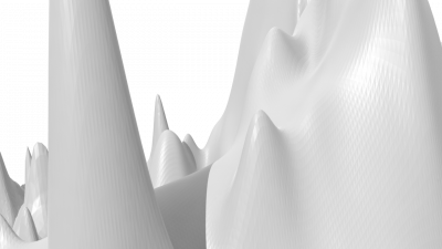

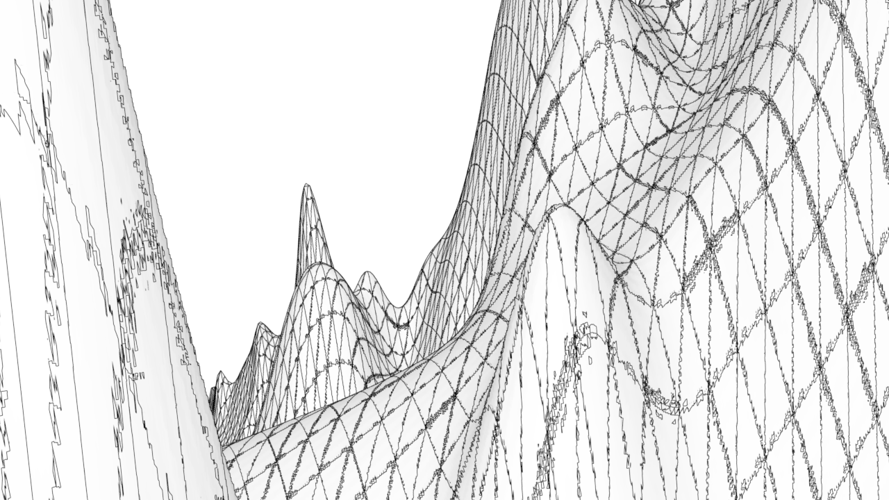

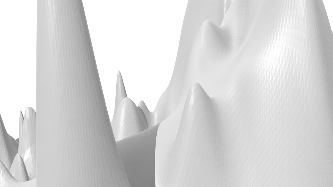

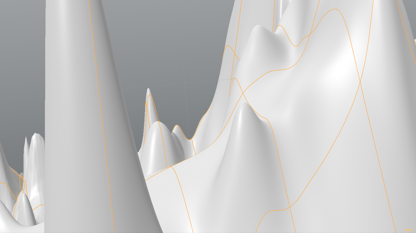

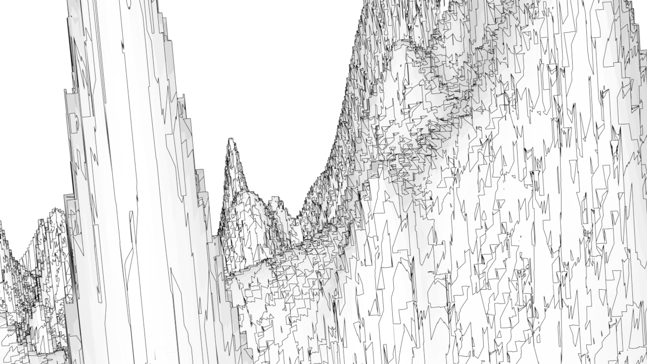

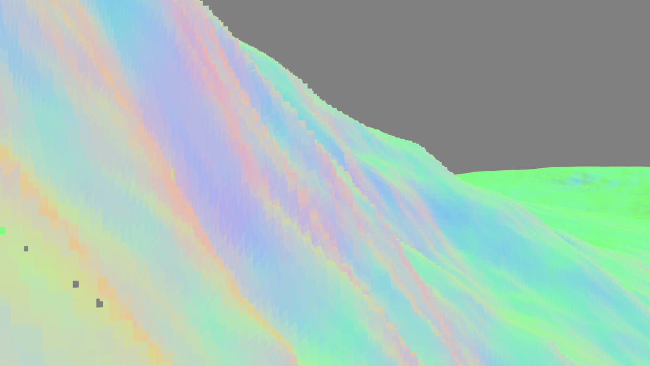

I'm having a serious distortion problem with displacement in octane, both modo and standalone.
It's a strange distortion, different from the "ridged steps" that others on the forum have posted.
The examples above are from a simple 512m by 512m "plane" displaced with a 8K 32 bit TIF heightmap (i can send it, but it's 120MB if i compress it with .7z ).
Tried a lot of combination:
Tried with heightmaps generated from landscape software, with ones created by me on photoshop, with ones acquired as stock image.
Tried with 8,16,32 bit depths.
Tried wit 1k, 2k, 4k, 8k resolution.
Tried with different "plane" sizes. .
The problem allways exist.
It happens inside modo AND on "standalone".

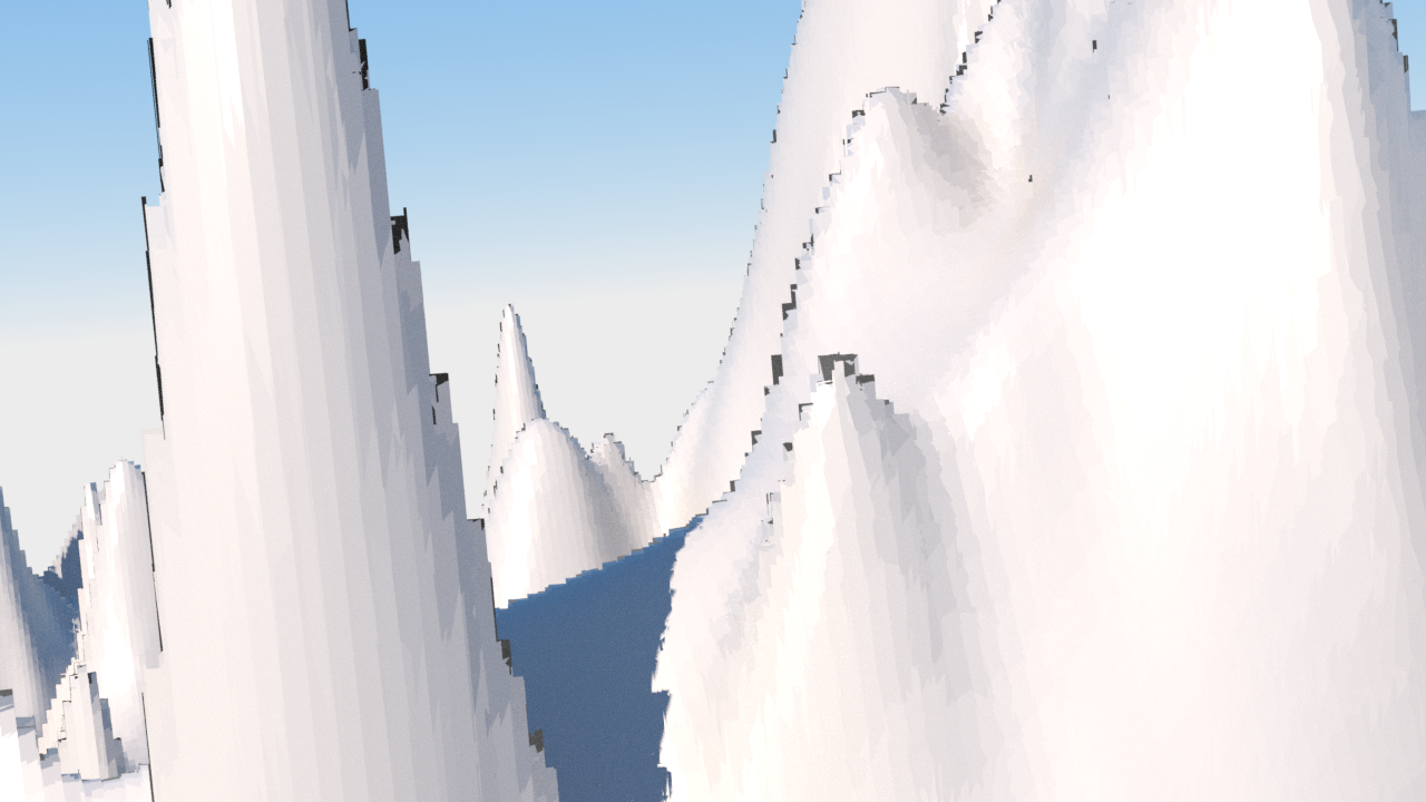

Here's another example :|
This time:
Displaced a 1mx1m plane using modo procedural texture.
Then baked it into a 8k 32bit float .exr heightmap
Then used that .exr heightmap in octane to displace the same 1mx1m plane
result: insane distortion

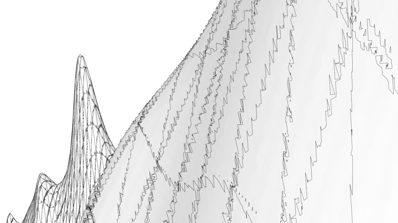

The wireframe kernel. Look at the "insane" wireframe!
Wireframe kernel
Wireframe kernel
and a second wireframe kernel rendered from a closer camera:
Closer camera
Closer camera

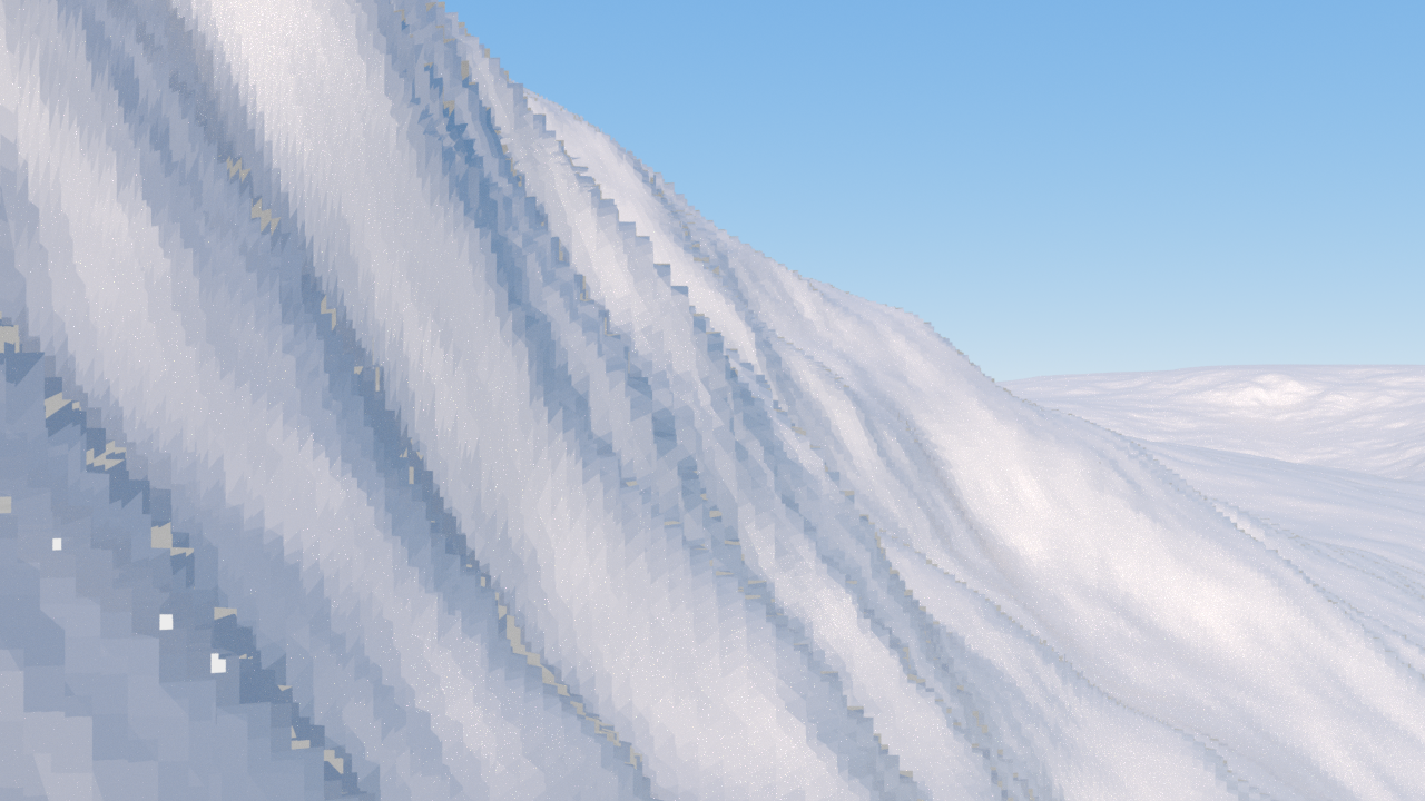

Just an update:
All the displacements above were made inside "octane schematic" through octane override and using the "displacement node"
If the displacement is made using on the fly material conversion from modo's shader tree, it's worst. The examples are with cathmull-clark: level 5
OCTANE
Live Conversion Render

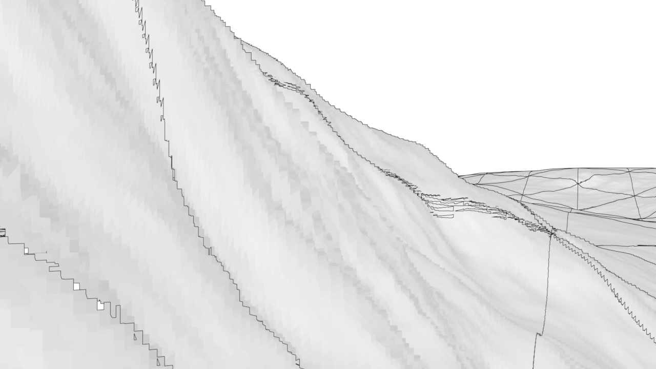

And the wireframe kernel
Live Conversion Render: Wireframe Kernel
