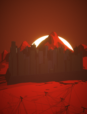

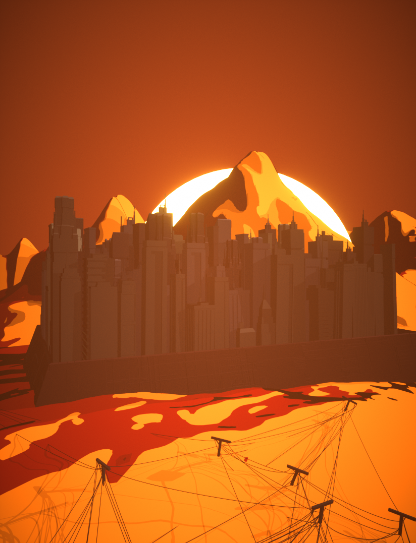

Hi guys,
Relative Octane newbie here but Im having a bit of a problem with Toon Lights.
When in Live Viewer, all the colours look really weird until I deactivate and reactivate the Toon Lights. This is fine for Live View but means that I get weird colours when trying to render to picture viewer.
Im running 3.08 RC3 so apologies if this has already been flagged + fixed.
Any help anyone can chip in would be very gratefully received!
How it looks after refreshing lights (this is how it SHOULD look)
How it looks before...

Just to follow up for anyone else that comes across this issue.
The problem seemed to be that I was using two different Toon Lights. Deleting one seemed to solve the problem.
