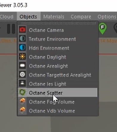

I've seen that it's very quick and easy to create lights in Cinema4D. With one click they are already set up. Especially the targetted light option is nice. In Blender I always have to create everything manually. Maybe you can add a section to the "Add" popup or have a section in the toolbar where Octane specific features are included (this is how Renderman handled it).
This is the popup of Cinema4D that I'm refering to (btw. it should be "Targeted" with just one "t").

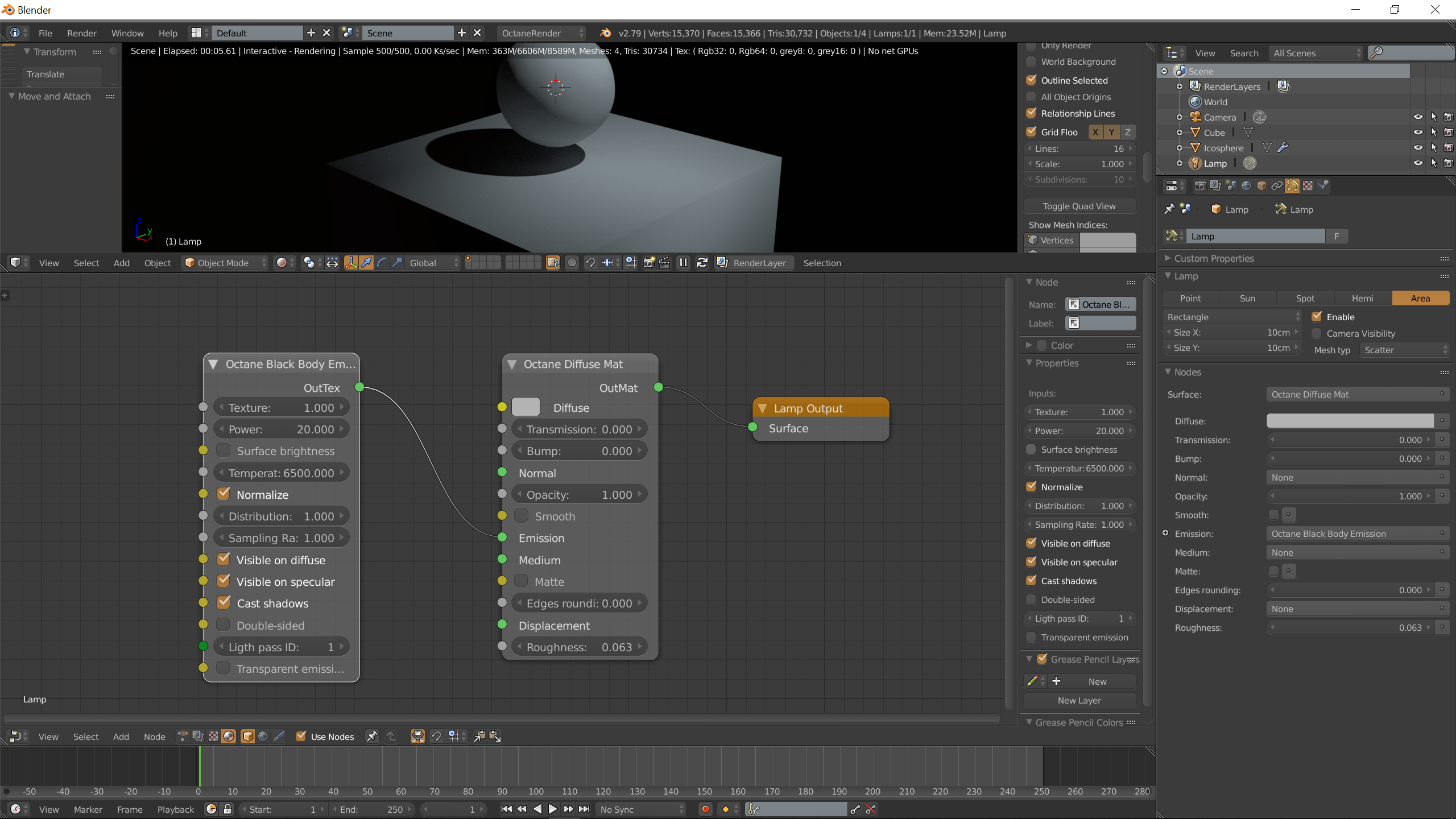

For sure BlenderOctane needs a fastest way to add specific light types to the scene.
Something maybe not anyone is aware about is that you can use a Blender Area Light as an Octane Area Light.
All you need to do is to activate Use Nodes for the light and attach a Diffuse shader+Emission.
Point and Directional Lights can only be used as Toon Lights for now.
The point is in Octane all lights are basically emissive geometry, so "Lights" (in the classic term 3D software users know them) need to be somehow implemented in some diffrent way in each software.
We'll work on some more direct way to create ready to use Octane Lights for sure.

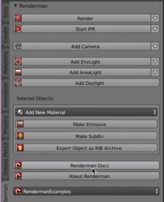

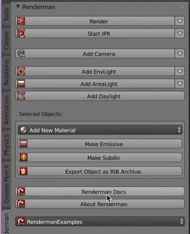

Yeah, this is all I want/need. Creating the nodes for the light each time is annoying. Just put everything that is a bit tedious in that panel. With time it can be expanded with more features.
Here's the panel that Renderman had in its addon. Plain and simple.
Cheerio,
Andreas
