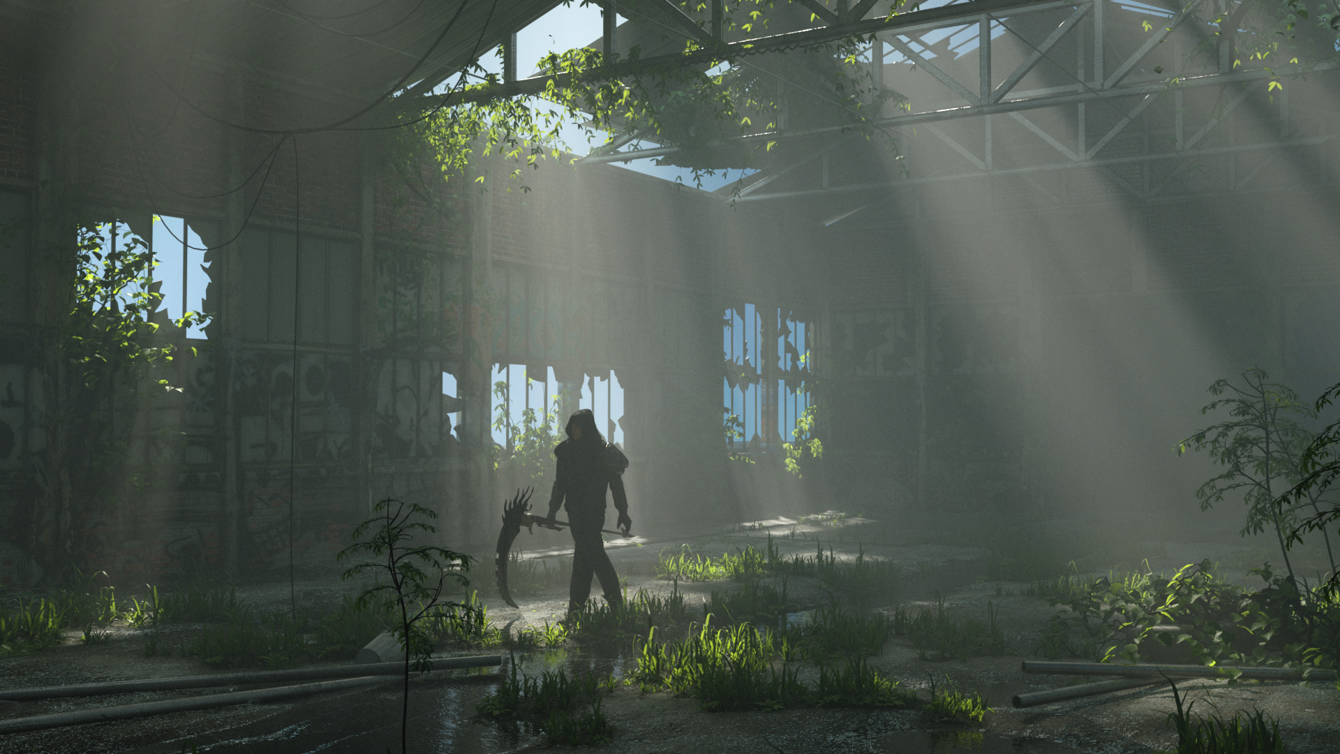

Simply use the "Medium" node in the Environment tab.
This will produce fog, similar to what you have in that screenshot there.
You need a strong light source to produce god rays like that (e.g. the Daylight Environment's sun) control the Density and the Radius via the sliders to achieve your desired result.
The "camera-outside-a-cube-volume"-method has become obsolete with introduction of the Medium node in the Environment tab.

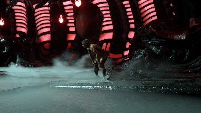

Sorel
Posts: 280
Joined: Tue Feb 25, 2014 5:22 pm
Ya if you need fog for your whole seen definitely use the settings in the environment tab now. I have another example if you need a more controlled look. Here I used cube primitive and stretched it across the ground and used some other flat planes for the rising fog.
