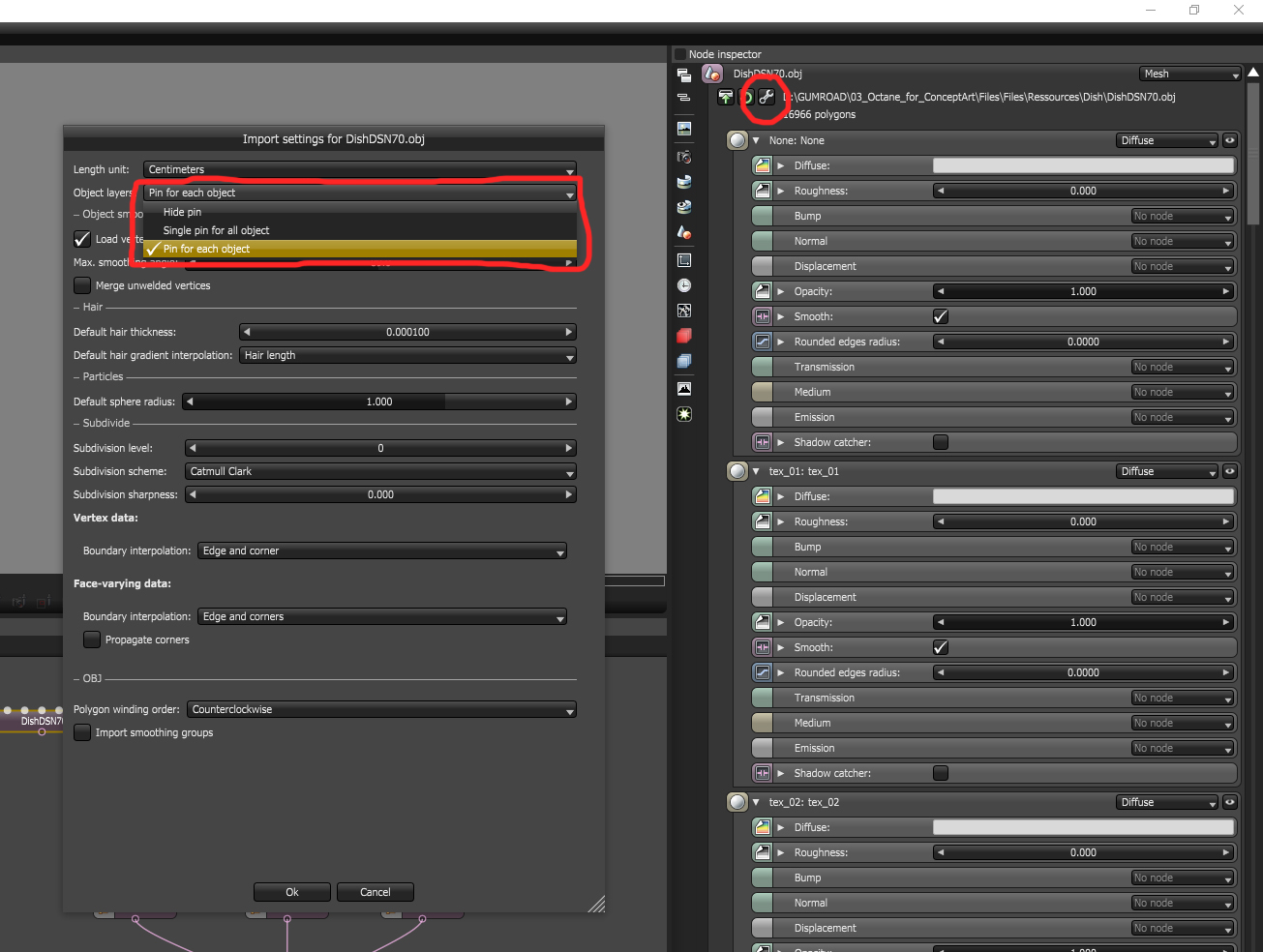

I'm not getting any object layer nodes when I import an object. However I see the objects node when I open an Octane document. Is there an option when importing?

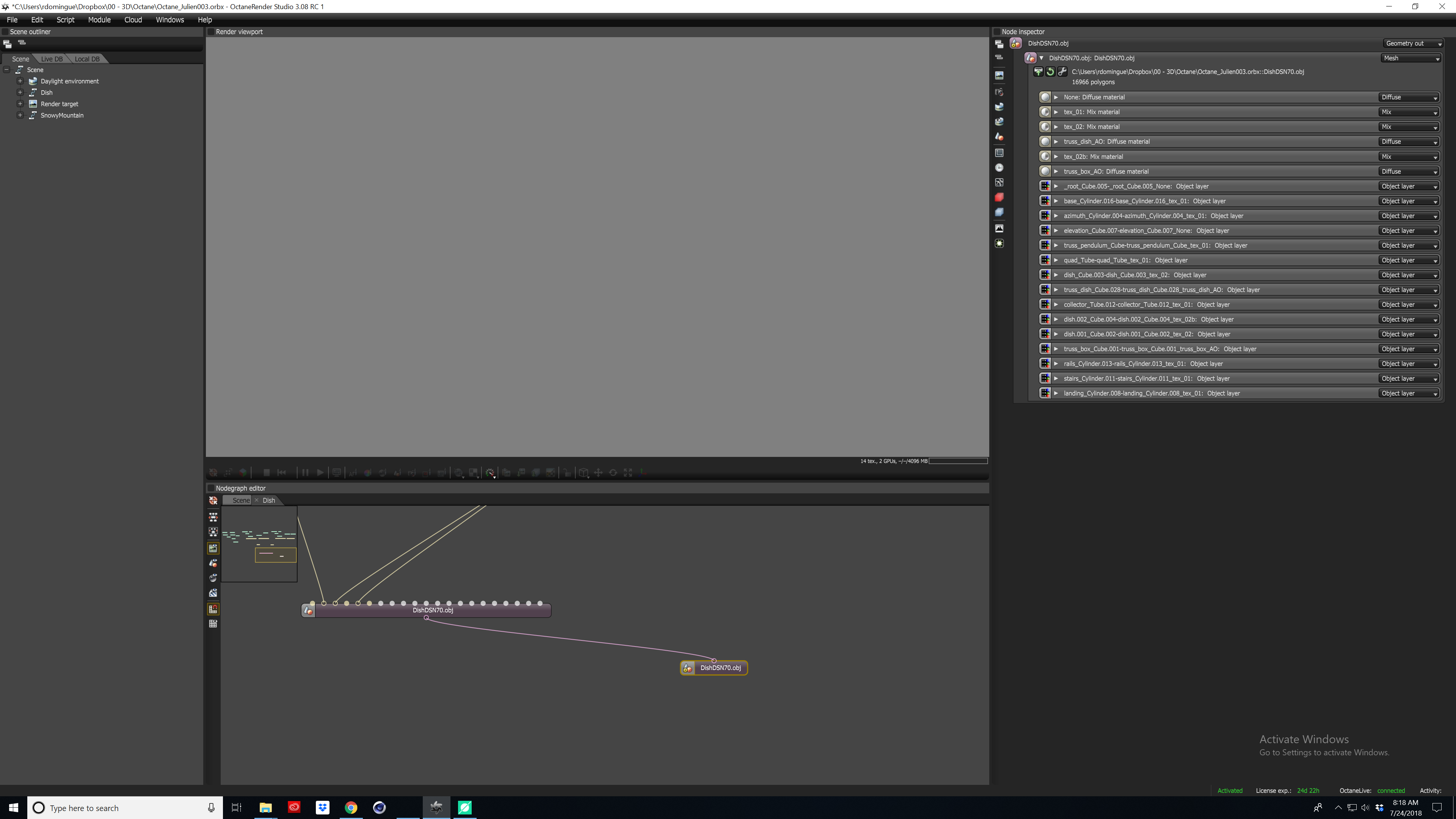

I'm following Julien Gauthier's tutorial and it seems the object layers are importing with the node. When I try to add them after I import the object it's just a blank node.
Object Layer Nodes
Object Layer Nodes

Found it in Import Settings under the Object Node. It's also in Import Settings under Preferences. Thanks to Julien for emailing me back. Thought I add it here to help close my discussion.
Octane Layer Node
Octane Layer Node
