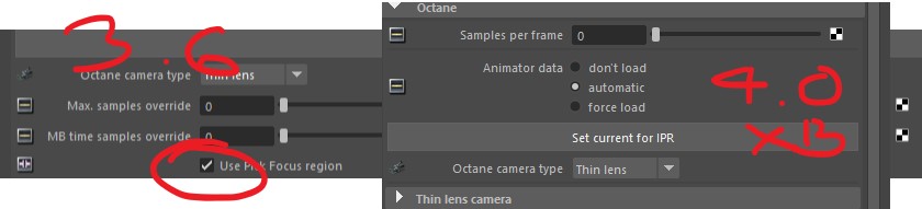

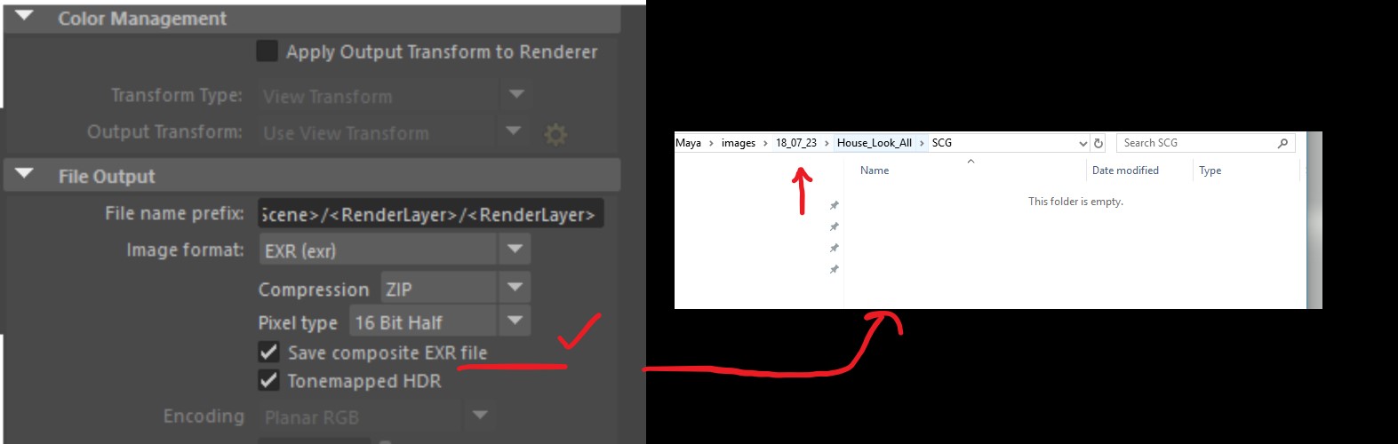

Hello BK
1 ) I cannot find " USE Pick Focus Region " For IPR in version 4.0XB
2 ) when i try render in exr " save composite EXR file " it not work
Render batch
Render batch

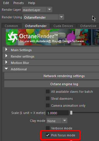

zurakan wrote: 1 ) I cannot find " USE Pick Focus Region " For IPR in version 4.0XB
Since the new branch plugin, this is now a global attribute. You can find it in render setting in the "additionnal" section:
Like before, to make the "pick focus" work, you need first to disable "autofocus" in the camera,
and to access Octane Render Region you need to disable "pick focus Mode" ....
In my opinion making this attribut global is an improvement, but discoverability and UI wording are still terrible...

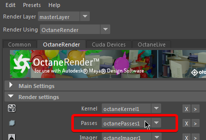

zurakan wrote: 2 ) when i try render in exr " save composite EXR file " it not work
To render "composite EXR" (multichannel EXR) obviously you need to define wich passes will be in the EXR, so first you have to link/create a pass node in "Render setting / Octane render tab/ Render settings section" :
Pascal ANDRE
